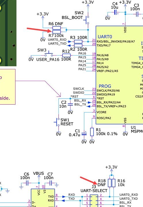

The BSL_RX and BSL_TX connections are used for uploading firmware via serial. To enable this, there is a BSL_BOOT button that needs to be held down during a reset. There are some non-populated resistor pads attached to the BSL_BOOT switch, because I’m unsure if that pin floats, or if the user may wish to permanently set that to a particular level.
Note: It was later discovered that this Rev 1 circuit is missing a 47k pull-up resistor, from the *RST pin (pin 6 on the microcontroller) to +3.3V. It was easy to patch onto the underside of the PCB.

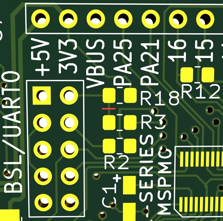

    shabaz 6 months ago in reply to Jan Cumps
    Interesting.. I was worried about something like this, but forgot to test this.
    I can't think of a good fix for that : ( It's annoying that the chip uses an input for boot mode which happens to be a pin that would idle high if connected to it's other purpose (i.e. UART). In the circuit, there's a weak pull-down (R7), but that will get overridden by the USB-UART chip which will idle high.
    Some possible ideas, all non-great:
    (1) The design could be modified in a rev 2 in order not to use UART on those pins, but that would restrict usage of other features only available on the remainder pins, so that has some negatives : (
    (2) If the MSPM0 chip allows it (I've not checked yet, but it might) configure UART to have inverted signals, and then have logic inverter gates on the RXD and TXD pins.
    (3) If both the CH340 and the MSPM0 chip allow it, configure both of them to use inverted signals! However, CH340K doesn't seem to have that capability : ( whereas, CH340K does, but it's a 16-pin part so again that would be a PCB modification, and is still dependent on if the MSPM0 supports the inversion too
    (4) Some way of temporarily overriding it low on reset, e.g. an AND gate could do it, using it inline with the RXD connection, and the other input wired to *RST. Maybe an easy-to-solder SOT23-sized SN74LV1T08DBVR for instance, and it could be bodged on the board, by cutting the track shown. Might actually be a tidy fix since all the needed connections are close by there.
    Of all of those, the only viable one is (4) on the current board. Even on a rev 2 board, options (2) and (3) are ugly, because they mean that code written to use the UART would be different to code written for (4), so even on a Rev 2, maybe option (4) is the one to go for (assuming it can work).
    Jan Cumps 6 months ago
    I think I found a board issue:
    When the UART jumpers are placed, the board doesn't start. Even after pressing reset
    If you place the UART jumpers after the board is running, it keeps running.
    Both after power up, or when pushing reset while powered .
    Same behaviour when RST jumper is mounted or not.
    Easiest way to replicate: use the demo program, and plug the USB in a PC with or without the UART jumpers. See LED flash behaviour.
