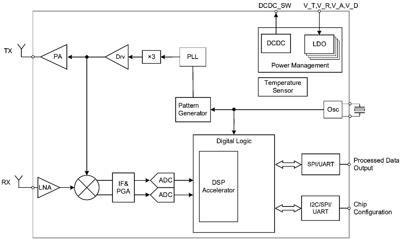

The LD2410 is a very small board, 35 x 7 mm, containing a microwave integrated circuit from a manufacturer I don’t recognize. There’s not a lot of detail about the chip or the board; they are mostly a black box, unfortunately. In principle, the device will transmit RF energy at microwave frequencies, and measure the energy bounced back, much like RADAR. As a result, the system can detect the presence of static or moving objects, and provide a report indicating the object type (static or moving), and a (very basic, ballpark) measurement of how near it is.
The device cannot provide an object count, nor can it indicate if the object is human, although the latter can sometimes be inferred if there is movement in a known deployed location. An object count could be achieved by deploying multiple sensors to cover different portions of a larger area, or by positioning sensors near an entrance or exit perhaps, but that is not a strength of this sensor; there are better options for that, such as thermal imaging sensors!
Exploring the Board
According to the board datasheet, the chip operates transmitting RF between the range of 24.0 to 24.25 GHz. The other side of the board contains a microcontroller from a manufacturer called ZhuHai Jieli.

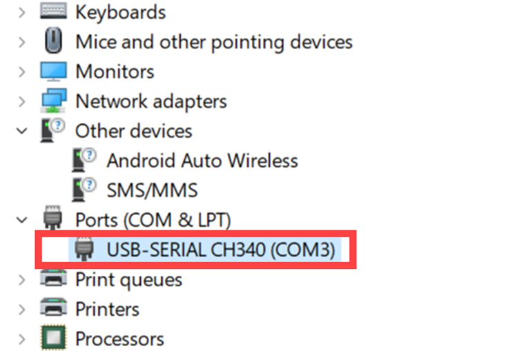

If you’re using the carrier board, you may need to install a USB-Serial driver on the PC.
The driver can be found on the CH341 driver page here.
Download and unzip CH341SER.ZIP and then plug in the device, and go to Device Manager and update the driver for the unknown USB Serial device that will appear there.

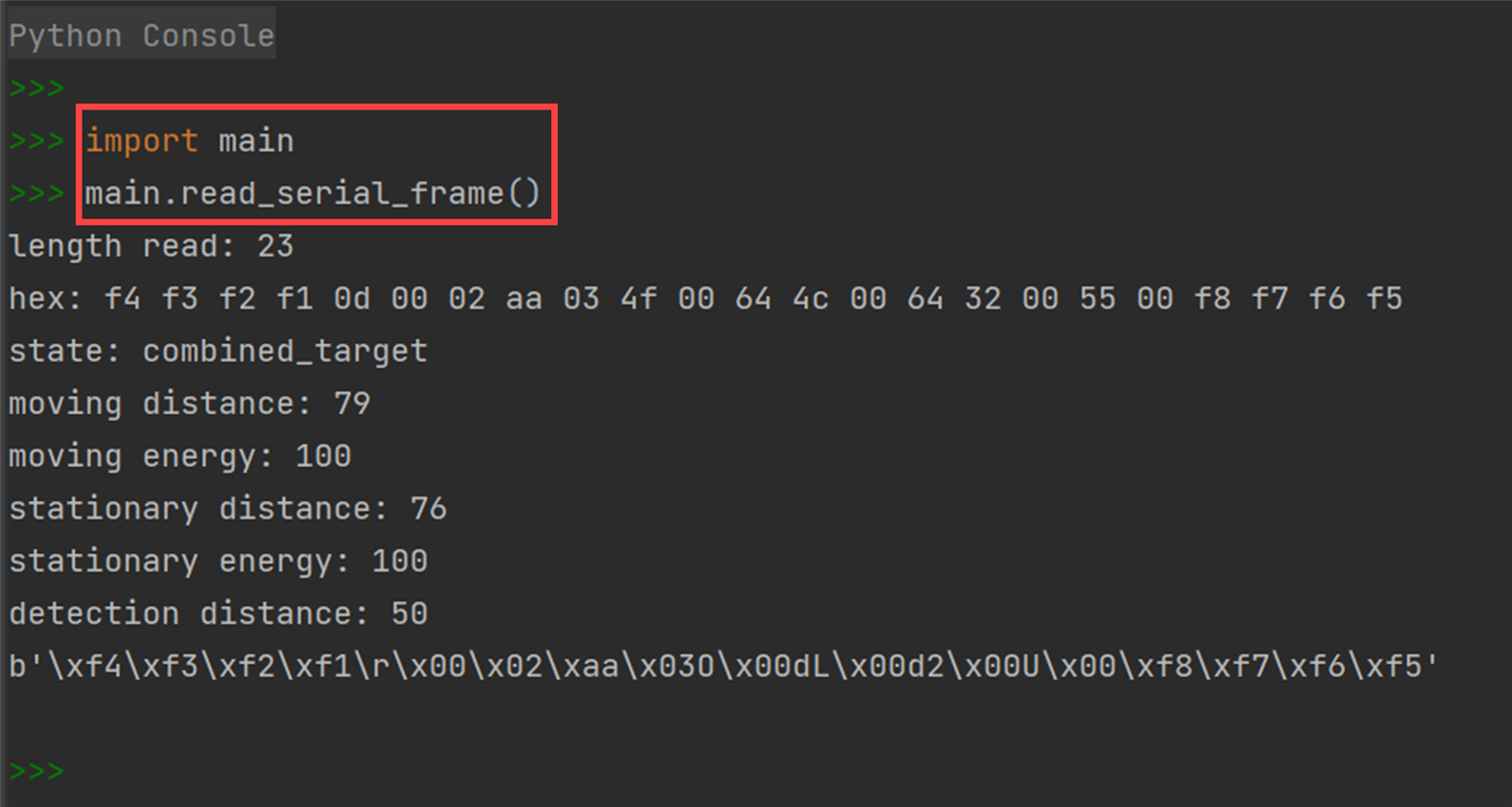

Here is an example report frame received over the UART connection, plus my interpretation of it:
Hex (23 bytes): f4 f3 f2 f1 0d 00 02 aa 03 4f 00 64 4c 00 64 32 00 55 00 f8 f7 f6 f5
State: combined_target
Moving distance: 79
Moving energy: 100
Stationary distance: 76
Stationary energy: 100
Detection distance: 50
The first four bytes are a header, and the last four bytes are a terminator sequence. It is described in the user manual, but there are errors in the document, so I’m not 100% sure I have got everything else all correct.

I wrote simple Python code to capture the reports and decipher them. It's very prototype-grade code but is sufficient to see how to use the sensor.
You’ll need to install the PySerial package. To use the code, edit the line containing the text:
portname = 'COM5'
Set it to whatever COM port your carrier board or USB-Serial adapter uses.
To run the code, type the following in a Python command prompt:
import main
main.read_serial_frame()
When that command is executed, the serial port will be opened, one frame will be captured, and the decoded output will be displayed.
