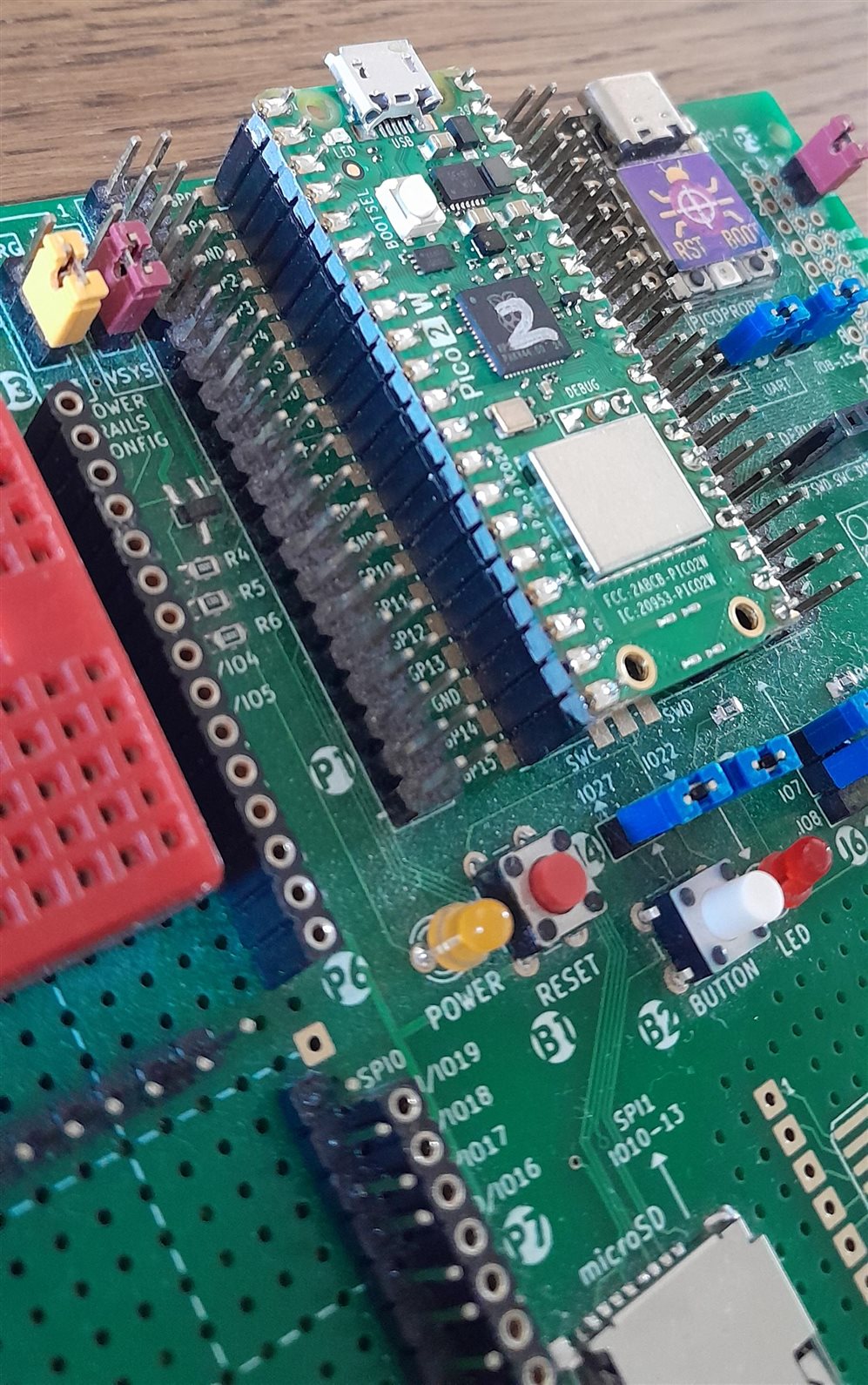

This is going to be an ultra-short blog post because the project is really short – it's a super-basic development board for the Pi Pico. I grew tired of having a Pi Pico dangling from the PC USB port with bits of wire hanging off it, just to do a bit of prototyping. Although the Pi Pico can be used as-is, there is some minimal circuitry needed for more effective use, such as a power supply, supply switching circuitry, and a reset button. Some space for assembling a few additional chips or modules would help too! So, that's what this project delivers on. See James' video (demonstrating the Rev 2.0 board) here:  Why You Need a Raspberry Pi Pico Development Board by Shabaz - Workbench Wednesdays 70

This project only does a fraction more than the bare minimum that could be needed to develop projects. There aren't any fancy features on the board; there's nothing to get in the way of the large prototyping area! The image here shows what the board contains.

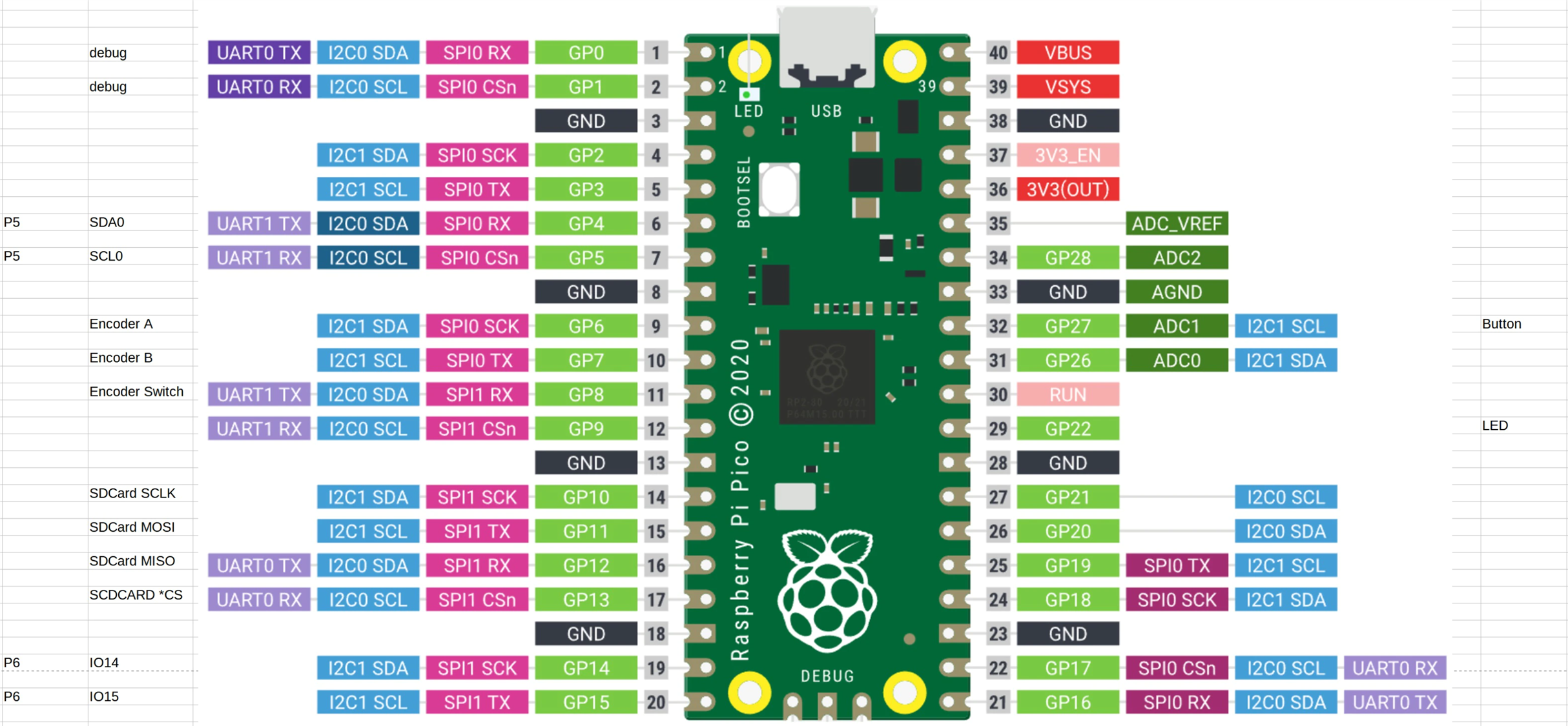

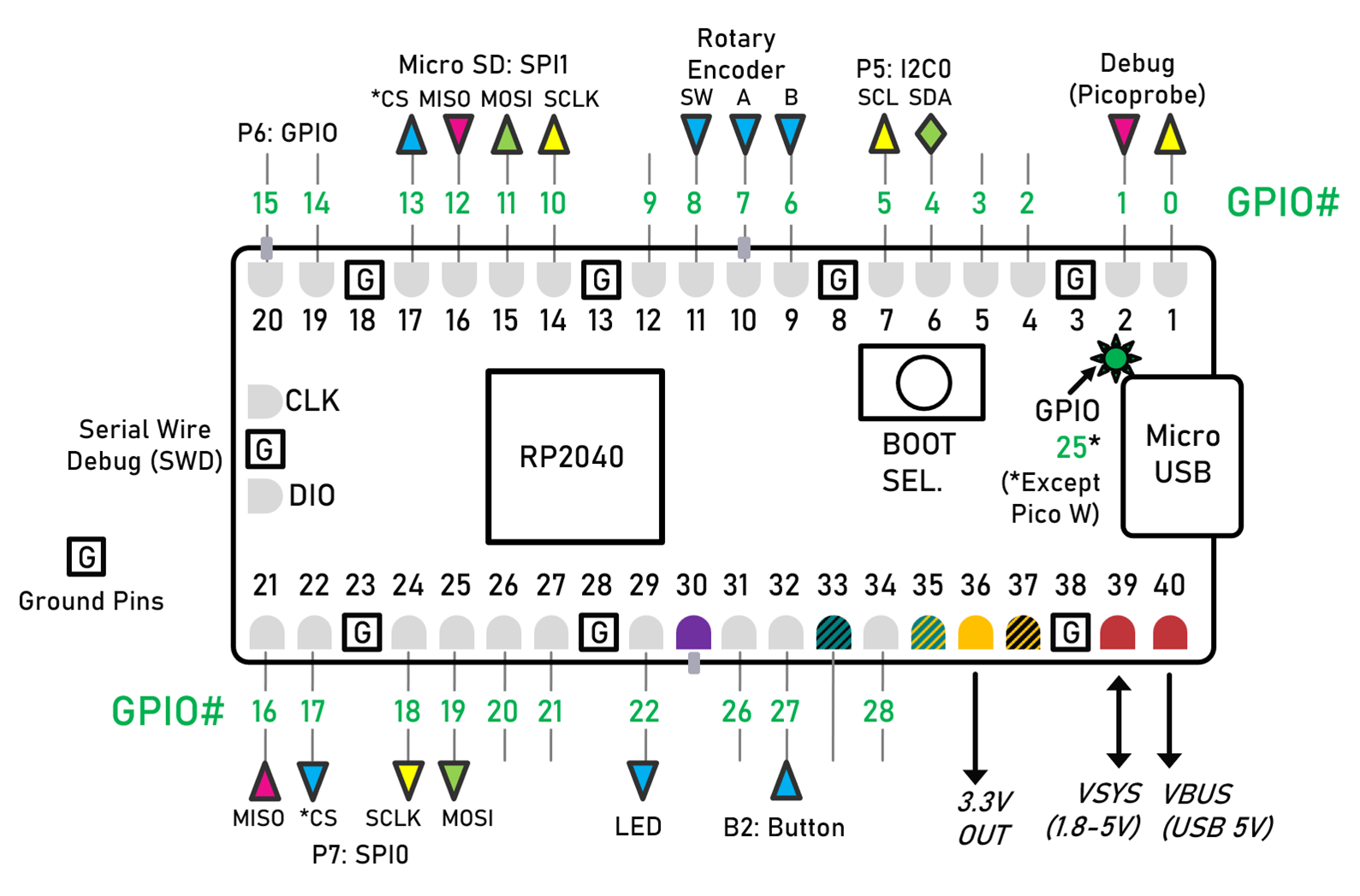

Pin Assignments
The default pin assignments on the board are shown in the diagram. The assignments can be removed or reassigned for most pins, by using shorting jumpers or jumper cables.
This diagram from Jan contains more detail:

    The Pico Eurocard works perfectly for the Pico2 family too. No hardware changes needed.
    Jan Cumps over 2 years ago
    Here's a few photos of the Eurocard with the ST Micro Teseo GPS board.
    image image
    This setup results in reliable connections. Angled headers allow to mount the board in an angle, a good position for a GPS device.
