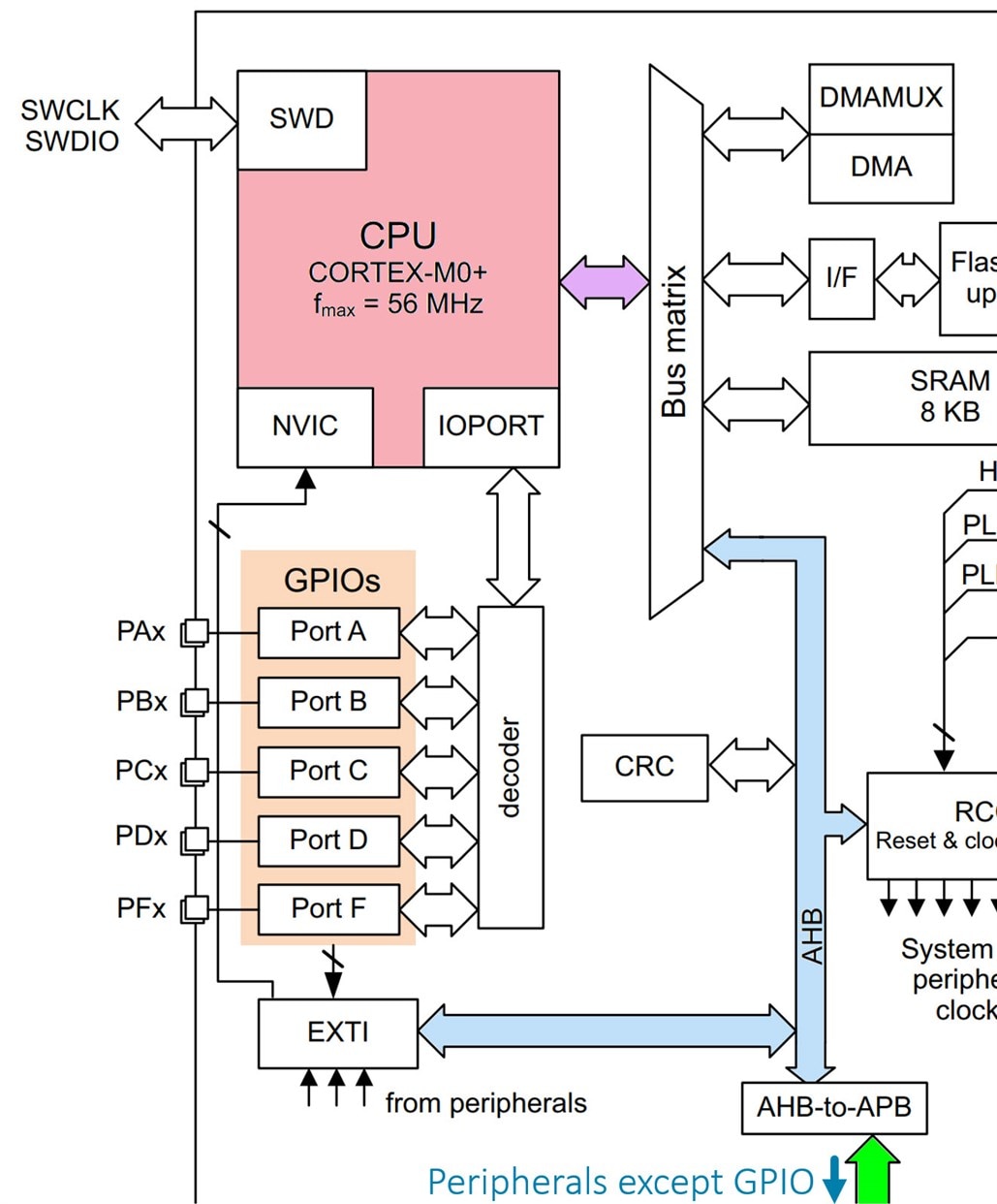

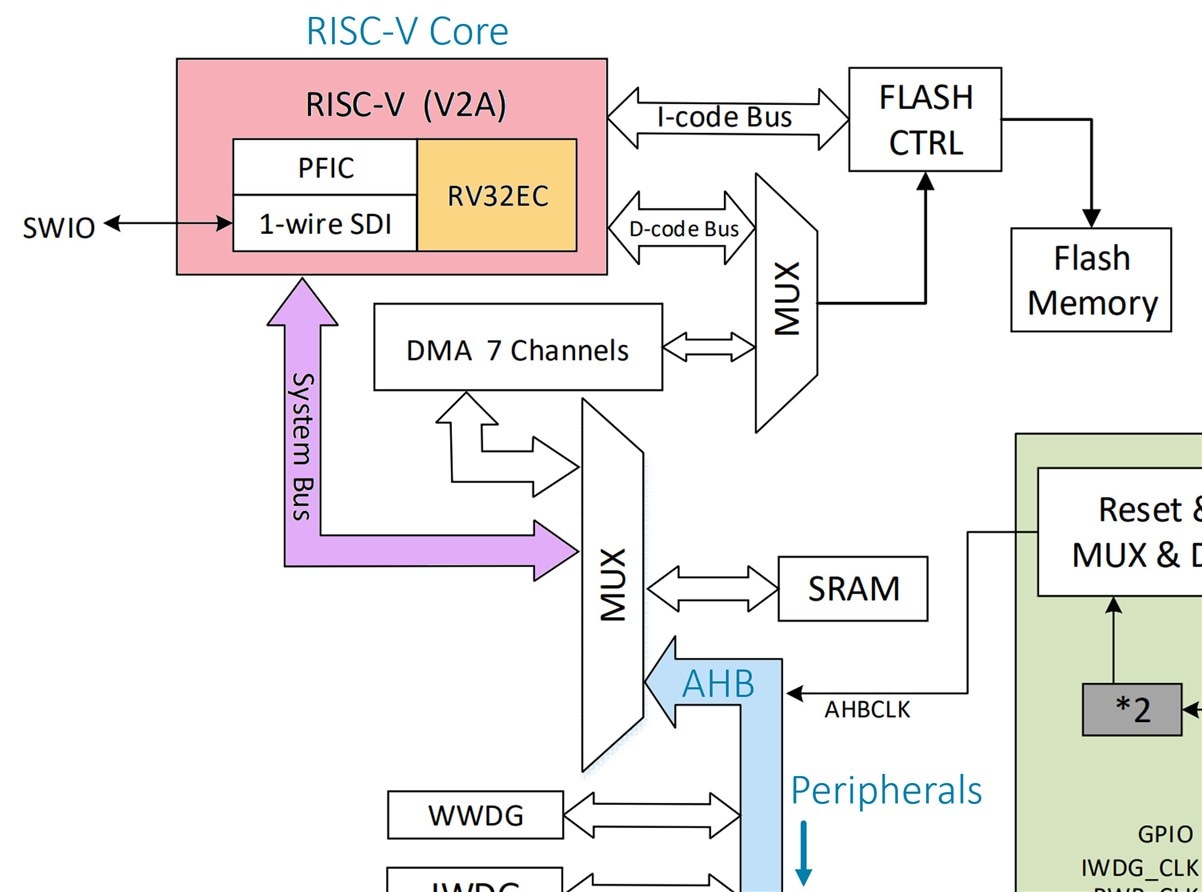

The diagram below indicates what the microcontroller contains! For more details, check out the datasheet and reference manual.
It comes in four different packages, ranging from an 8-pin device, up to 20-pin. All pins apart from the supply and ground pins can be used as GPIO, meaning up to 18 pins of GPIO are possible.
All the alternate functions for the GPIO pins can be easily controlled by a single 32-bit register called AFIO_PCFR1. All external interrupts can be enabled using a register called AFIO_EXTICR.
The CH32V003 operates from 2.8V to 5.5V, and current consumption ranges from up to 8mA (every peripheral enabled, and at 48 MHz clock speed) down to 400uA in a 750 kHz sleep mode (peripheral clocks can run), and 11uA in standby (no clocks running, but GPIO pin interrupts are available to wake up the device).
The CPU core runs an instruction set called RV32EC, which apparently means embedded integer capabilities and compressed instructions (ability to reduce instructions to 16 bits instead of 32 bits, where feasible). I believe the instruction set can be found here.
The microcontroller is programmed using just a single wire called SWIO. The USB programmer is low-cost, called WCH-LinkE. In reality, it is useful to dedicate two wires to the programmer, the other being either the *RST connection on the microcontroller, or the supply (VCC). Either *RST, or control of the supply voltage can allow the programmer to initiate programming. By default, all pins other than SWIO, *RST, VCC and GND pins are GPIO. The *RST pin can be set to GPIO mode by configuring an area of Flash, which can be done by the programming tool, or from the code running on the microcontroller.

    Thanks very much for this - helps crystallise my thoughts re. cheap RiscV parts:
    Interesting how closely they have cloned the ST library format for their peripheral control code.
    Easy for us to learn but shows a lack of innovation and is maybe a missed opportunity. Might also be subject to litigation. It's a huge contrast with GigaDevices who went out of their way to rename every single pin and register in their ST ARM "clones" and have a quite different library code structure.
    Comparing with the real thing
    STM32G030F6P6, 32kfkash, 8k RAM, 64MHz, 20 pins £1.16 each for 10 - so I think I'd stick with ST and ARM unless the numbers were huge and the application not at all demanding.
    The ST Nucleo for the STM32G030F6P6 is only £9.29 so dev tool and 5 chips (at Farnell prices) will set you back £16.19.

    I believe this is the second RISC-V part I've tried, but this is the first time I've seen that they have connected peripherals internally to the core using AMBA, i.e. the same interconnects that ARM microcontrollers use (the CH32V003 is using AHB for all its peripherals in this case, no APB).  This is a snippet from the CH32V003 datasheet:
    The ST/ARM approach in the screenshot below, there is a separate I/O port from the core, so GPIO might be faster on ARM than the RISC-V implementation above:
    (This is from the STM32G030 datasheet):
