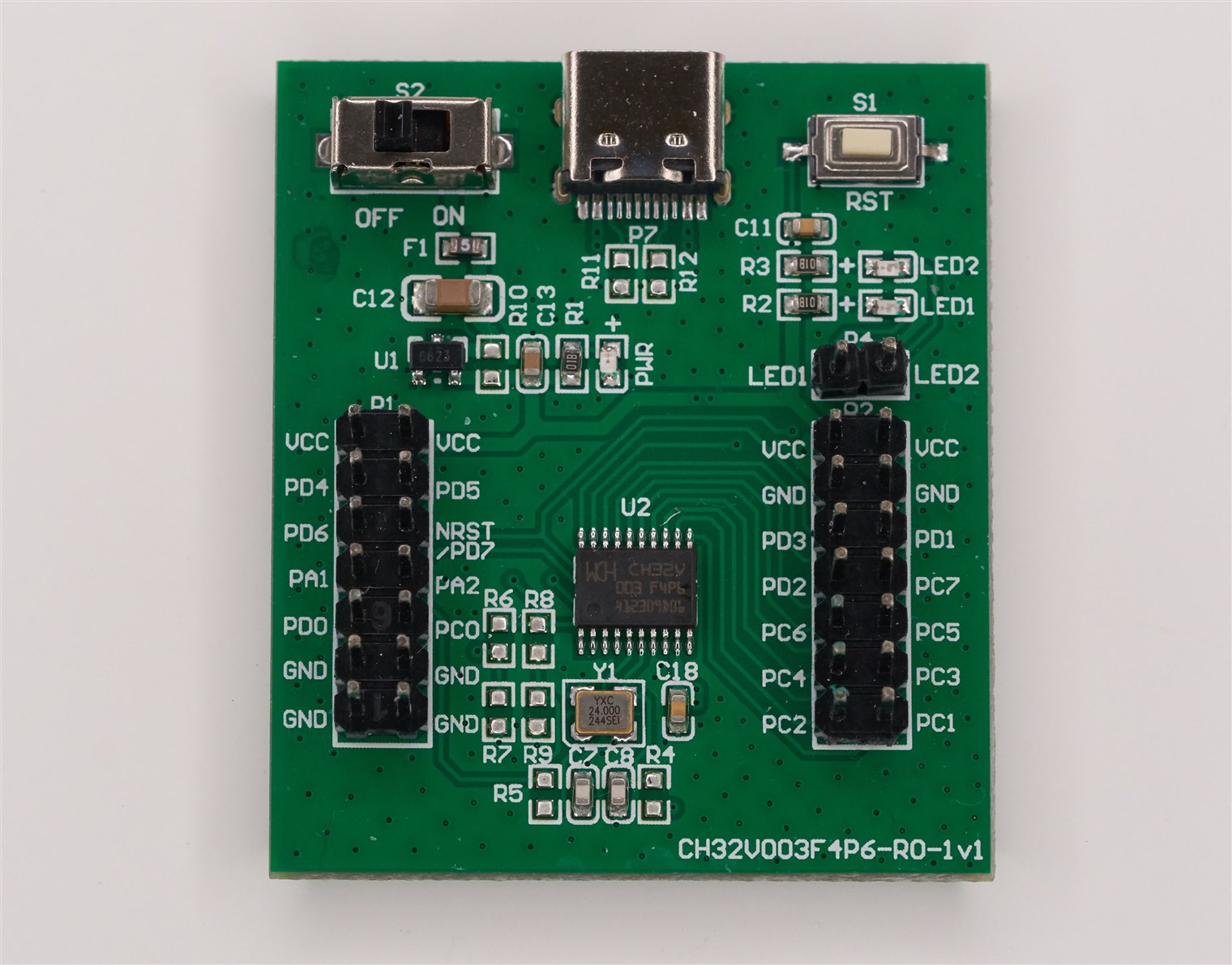

Despite purchasing some chips, to start off with, it’s probably best to pick up a small evaluation board since they are cheap. I obtained an eval board called CH32V003F4P6-EVT-R0.
Plus, importantly, a USB programmer tool called WCH-LinkE is required.
Everything, including five TSSOP-20 chips, all cost about $12/£12.

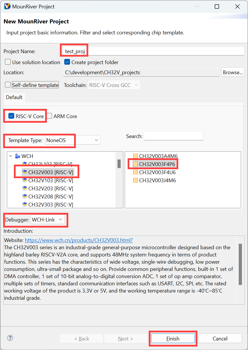

There are several development environments for the CV32V003. For now, I only tried the manufacturer-suggested one, called MounRiver Studio.
It is based on Eclipse, which means there is some familiarity for developers.
Once the software is installed (it only seems to be available for Windows, but there are other googleable open-source options available for Linux and Mac users), it can be started, and then File->New->MounRiver Project can be selected.
The window is populated as shown below, to select the microcontroller. Note that the Project Name needs to be set last because each time you modify the microcontroller selection, the project name defaults back to match the microcontroller name.
The main MounRiver Studio window view looks as shown below. In Eclipse terminology, it is known as the Code or Develop Perspective.

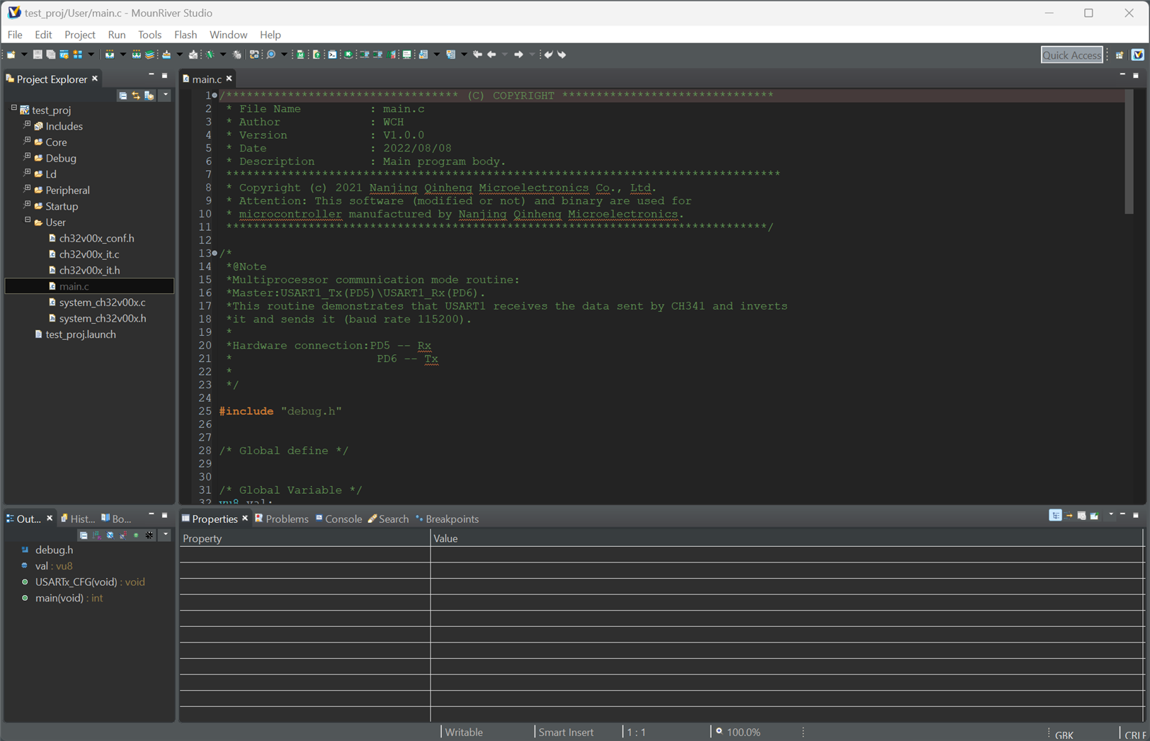

Editing the Default Code
The newly created project will contain default code. From the left side Project Explorer, expand the User folder, and double-click on main.c to have it appear in the coding pane. The default code reads data from the UART in the microcontroller, inverts the bits, and sends it back out of the UART.
I changed the line:
USART_SendData(USART1, ~val);
to:
USART_SendData(USART1, val+1);
Now, the UART should send back a character one ASCII code higher than what is typed by the user. Save the file (Ctrl+S), and then move on to the next section!

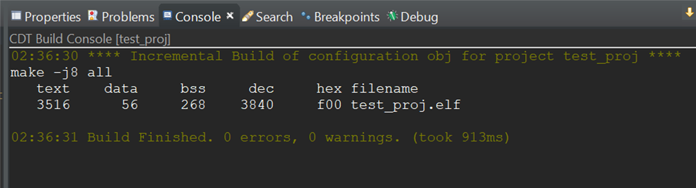

Building (Compiling) the Code
Click on the Build Project (F7) icon. The project will be compiled, and the result will be displayed in the Console tab in the lower pane.

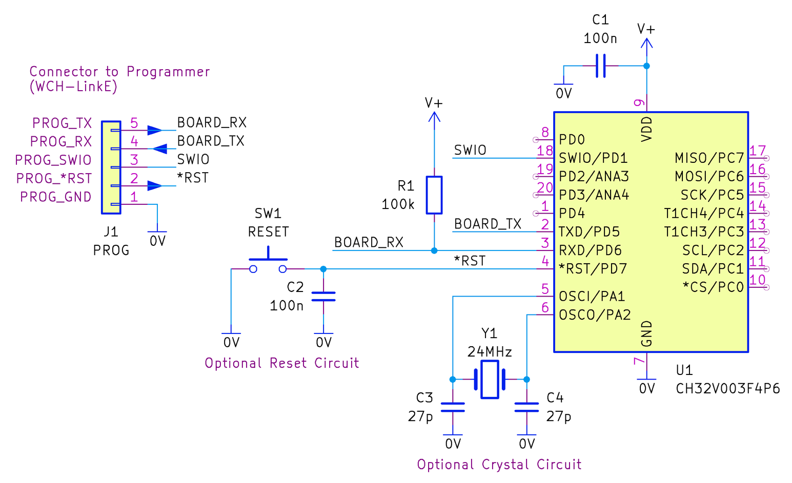

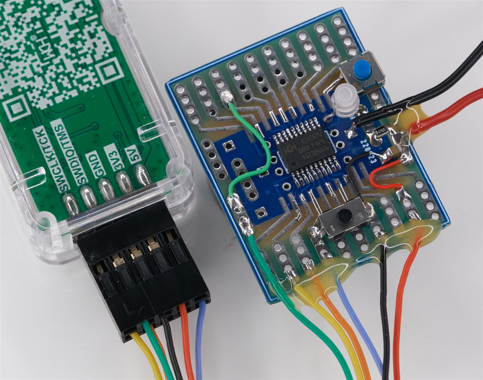

Build Your Own Board
The CH32V003 needs no additional components other than a decoupling capacitor to function, although adding the optional reset circuit (button plus capacitor) is highly recommended.
The circuit diagram shown here was assembled.

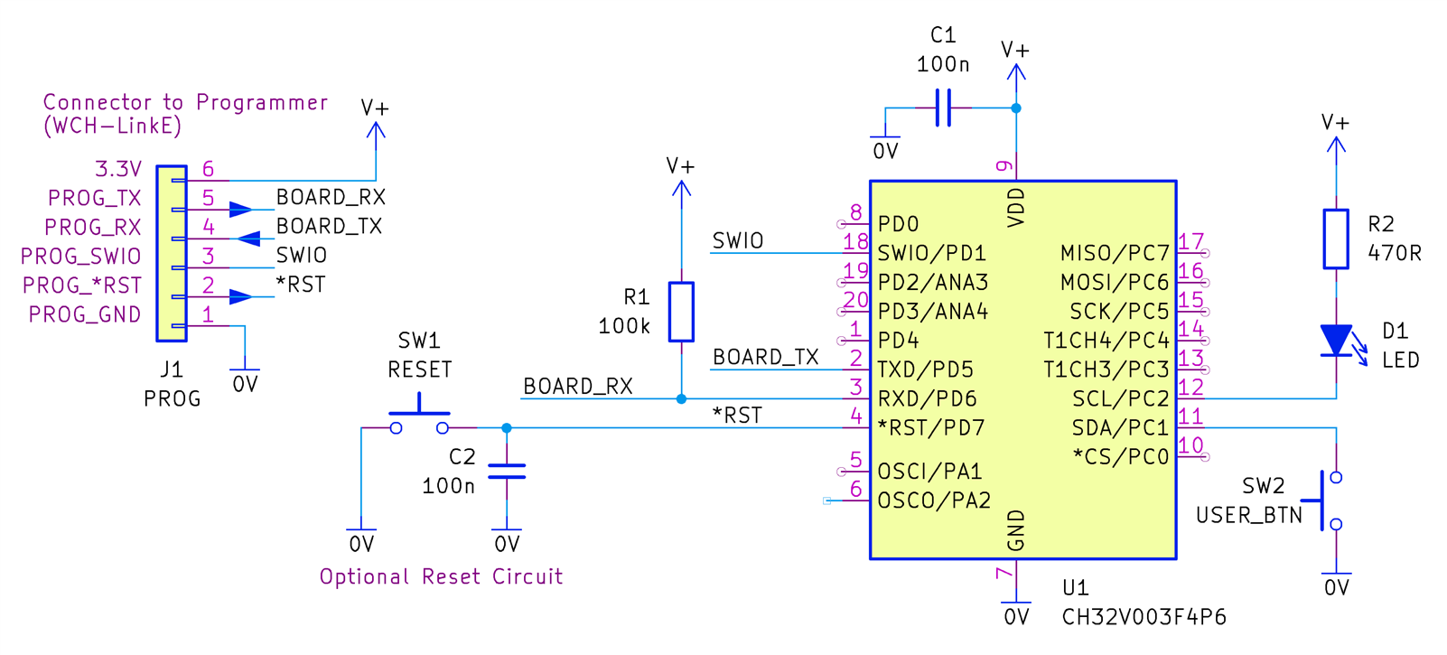

Coding
Now that the custom board was assembled, it was time to explore coding a bit more! The following sections indicate code snippets for the custom board. The full code is available here. The snippets below are from the main.c file.
