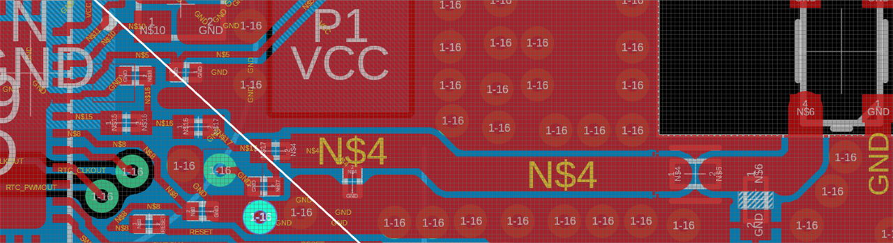

For now, I just give it a try to Fusion for personal user. Here is a 2-layer PCB layout design. I personally found Fusion 360 for PCB easy to use and it has some nice features that helps developer to create complex PCB.

    shabaz over 1 year ago in reply to embeddedguy
    (Mobile so I can't type much).
    The issue is this bit:
    "On the bottom layer there is entire GND plane that is from the pin on the SoC to the Antenna".
    Although there is copper there as you say, it doesn't actually connect to the IC except after having gone further around the board hopping between vias, until it reaches a single via near the top-left of the IC (I colored that in green in an earlier comment). Via holes under the IC will help with that (they were not present in the Gerber files I looked at.).  It needs to connect very close to the RF trace, instead of having to go around the board as mentioned.
  • embeddedguy
    embeddedguy over 1 year ago in reply to shabaz
    Ok. Let me clarify that thing again.  So, on the top layer I have GND plane around the track that leads to the ANT. As the below.(N$15 till N$6) is the track.
    On the bottom layer there is entire GND plane that is from the pin on the SoC to the Antenna. As below for the same track.
    Is there anything that I am missing here? I understand that these separate planes are connected to each other with tracks and VIAs as well.
    For the SoC pad that is also connected using Vias to the bottom GND layer as pointed by you in the dev kits and also as seen in above pictures, when I try to do that there is a error of Overlap (SMD-VIA). I need to find the workaround for that.
