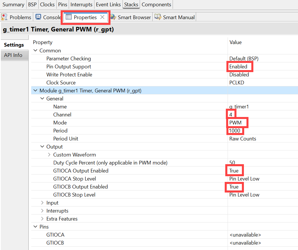

As with all other peripherals, use the FSP Configuration pane (see the earlier blog post for information on this) to click on New Stack->Timers->Timer General PWM to add a stack. This particular timer peripheral is called r_gpt and you can search for it in the RA4M1 user manual, and the FSP API documentation to learn more about it.
Next, in the same way that peripherals were configured in the previous blog post, click on Properties and configure as shown in the screenshot below.
As mentioned there are multiple timer module instances inside the microcontroller, and I wished to use PWM on pins labelled GTIOC4A and GTIOC4B, and so the value 4 needed to be selected at Module->General->Channel.
The PWM period is set with the Module->General->Period parameter in the screenshot above. By default the clock source is PCLKD which is set to 48 MHz on the RA4M1 evaluation board. So, if you want a PWM frequency of 10 kHz, then set the parameter to 48M/10k = 4800. I wanted a frequency of 48 kHz, so I set the parameter to 48M/48k = 1000.

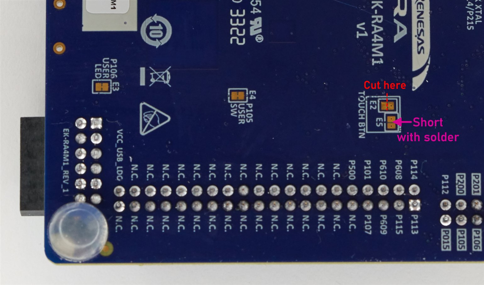

The RA4M1 evaluation board uses P115 for touch-button user input, which is not what I wanted. To disable the touch interface and use P115 for general I/O, cut the shorted pads labelled E2 on the underside of the board, and then bridge the pads labelled E5 with solder, so that they are shorted (see the photo below). Now the pin P115 is usable for PWM purposes.

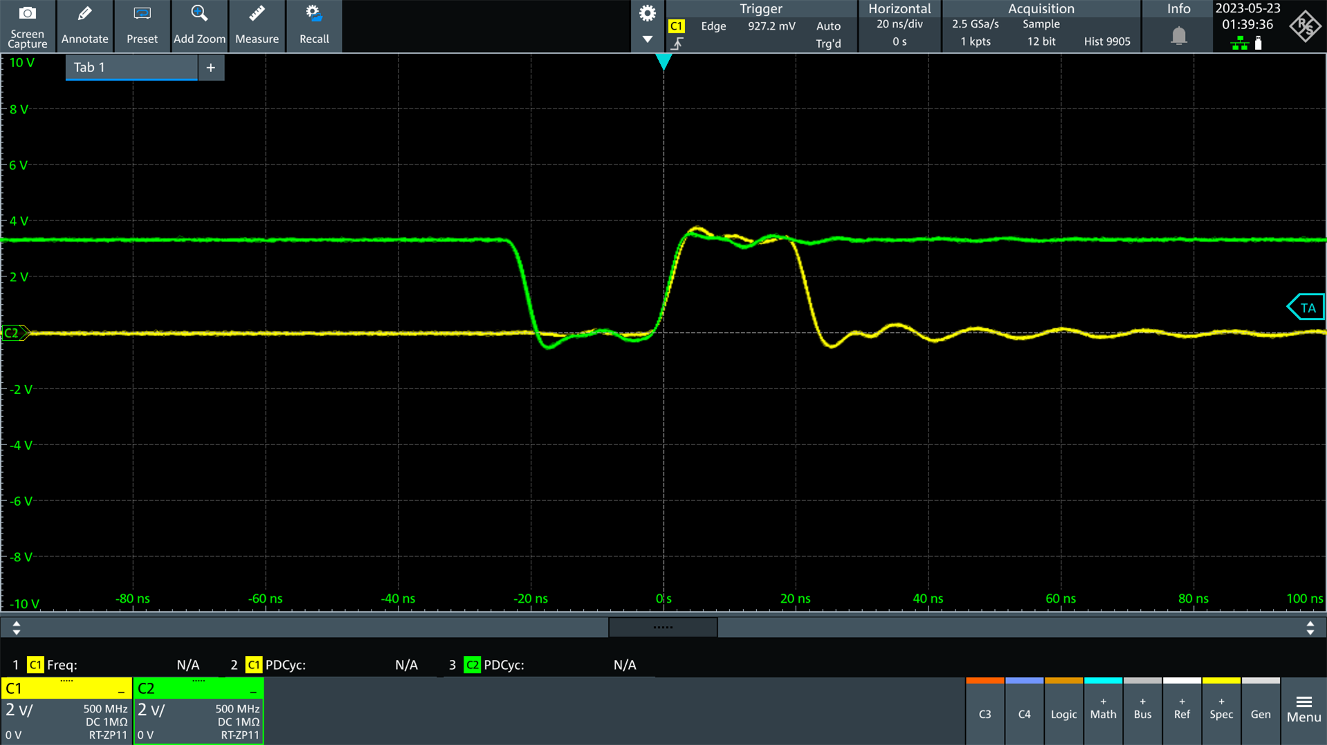

To test the code, I added the pwm_set function call into the USB code developed in the earlier blog post. By pressing keys on the PC, it was possible to adjust the PWM up or down. The screenshot below shows the PWM outputs set to 25.0% (yellow channel) and 75.0% (green channel):
With the 48 MHz clock sourced 48 kHz PWM rate, it is possible to have 0.1% duty cycle granularity which is great. The screenshot below shows the PWM rate set to 0.1% and 99.9% for the two outputs. The ripple is a result of probing and the long traces on the large development board.
