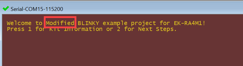

I edited the code to print a custom message within the menu. The modified file was called src/hal_entry.c - this file contains a hal_entry function which is effectively where user code execution begins after the C environment is started up. You won't be writing code in a traditional main() function because the auto-generated main function calls hal_entry().
Note that you cannot just click the hammer icon and let the code build., because the first step is configuring the project. To do that, double-click on configuration.xml in the Project Explorer and wait for a configuration view to display in the main pane. It will be in a Summary tab, but there are other tabs to explore too. Click on Generate Project Content. Some information briefly appears in the status bar at the lower-right of e2 studio, but other than that, it’s easy to miss that the Generate Project Content button has done anything, but it has! Typically, it will create auto-generated code in the ra_gen folder.
Now you can click on the hammer icon and the code will build.

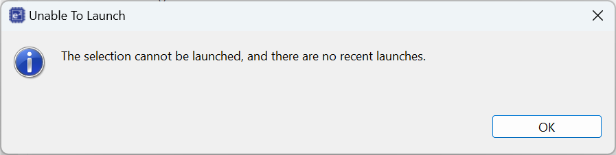

Click on the bug icon, and eventually, a J-Link Firmware Update window may appear the first time. Click on Yes. Afterward, once the firmware is updated, you may need to press the bug icon again.
Setting up a Debug Configuration

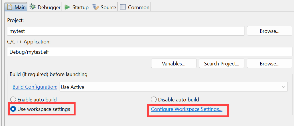

Note that if you press the bug icon and get a message as shown in the screenshot below, you’re probably running a new project and have not set up any ‘debug configurations’ yet. If you don’t get any error messages, skip to the next section.
Click on the small black triangle next to the bug icon, and select Debug Configurations. Right-click on Renesas GDB Hardware Debugging and select New Configuration.
In the window that appears, click on Configure Workspace Settings. Close the window, and then see if a default Debug Configuration has been created. I think there’s a bug, because you should not need to do this. I only encountered this problem on my first project, and subsequently, I always saw a <project_name>_Debug_Flat configuration for future projects.
If this doesn’t work, you may need to configure the tabs in the screenshot above manually. In that case, in the Debugger tab, select J-Link ARM and select R7FA4M1AB for the target device. I didn’t need to do this manually.

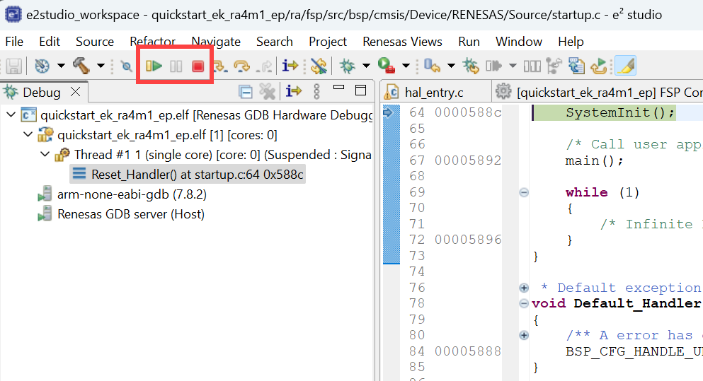

Click on the bug icon. When the Eclipse view changes to the Debug Perspective, you can click on the green triangle to run the code. Press the green triangle a second time if the code immediately stops because the Debug Configuration has been set to automatically insert a breakpoint at the main() function (you could remove that from the configuration if desired).
You should see the red LED blinking on the development board because that is what this code is supposed to do. Use a serial terminal (such as PuTTY) and press Enter to see the modified message appear, which proves that the modified code was successfully built and uploaded to the board.

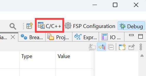

Press the red stop button, and then switch back to the C/C++ code view by clicking on the C/C++ perspective button near the top-right of e2 studio.
Note that the code is permanently in Flash memory. If you disconnect the USB power/debugger cable and reconnect, or if you press the Reset button on the board, the code will automatically run.

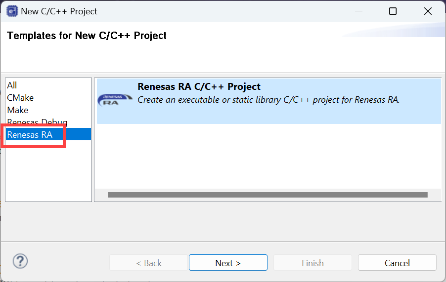

Creating a New Project

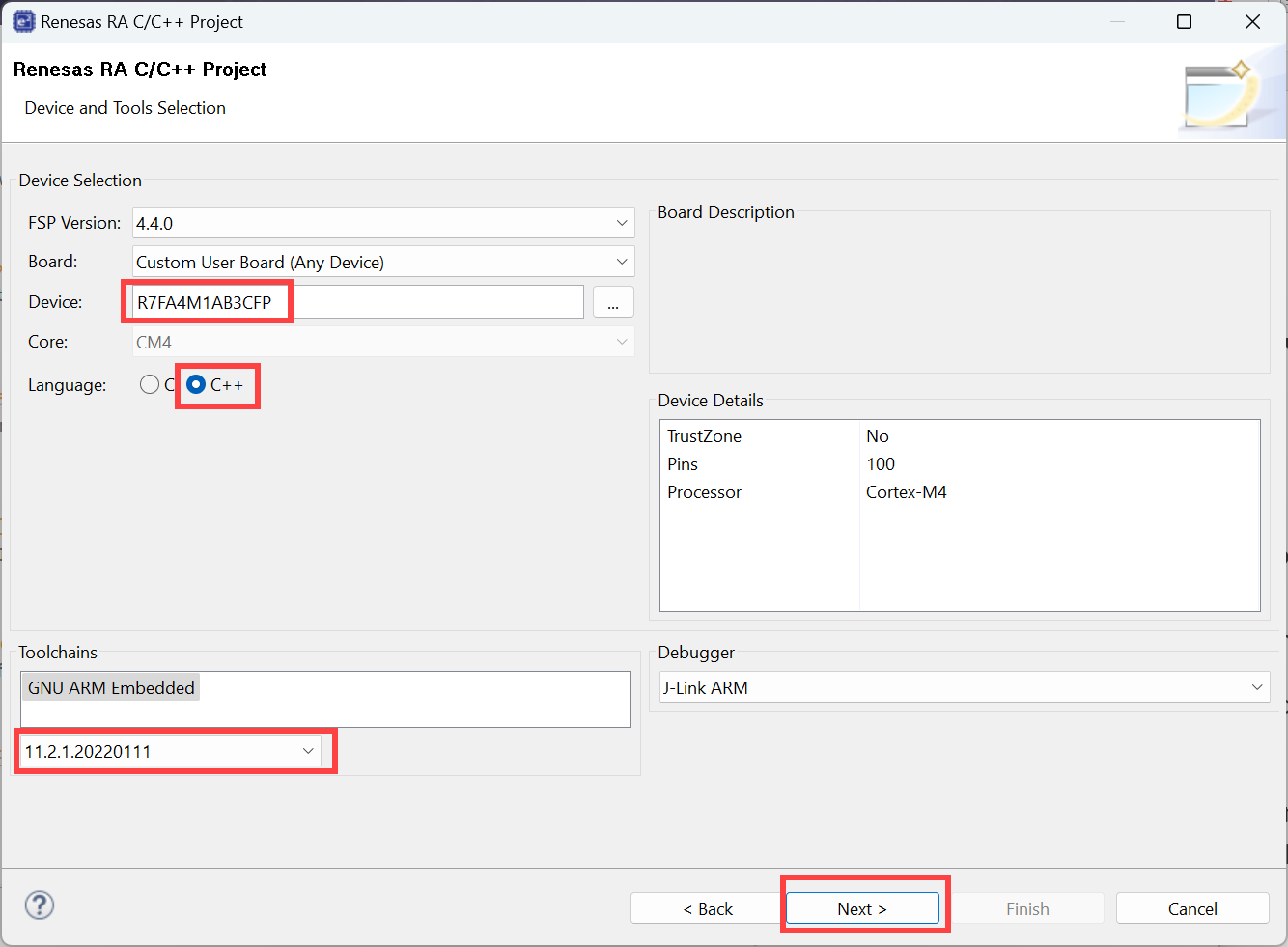

Click on Help->Welcome and then select Create a new C/C++ project.
Select Renesas RA.
Select the correct part code and the latest toolchain (if you have more than one toolchain installed on your PC). Select C++ if that’s what you prefer.
The project will be created, and you can click on the hammer icon to build it successfully, although the project currently does nothing.

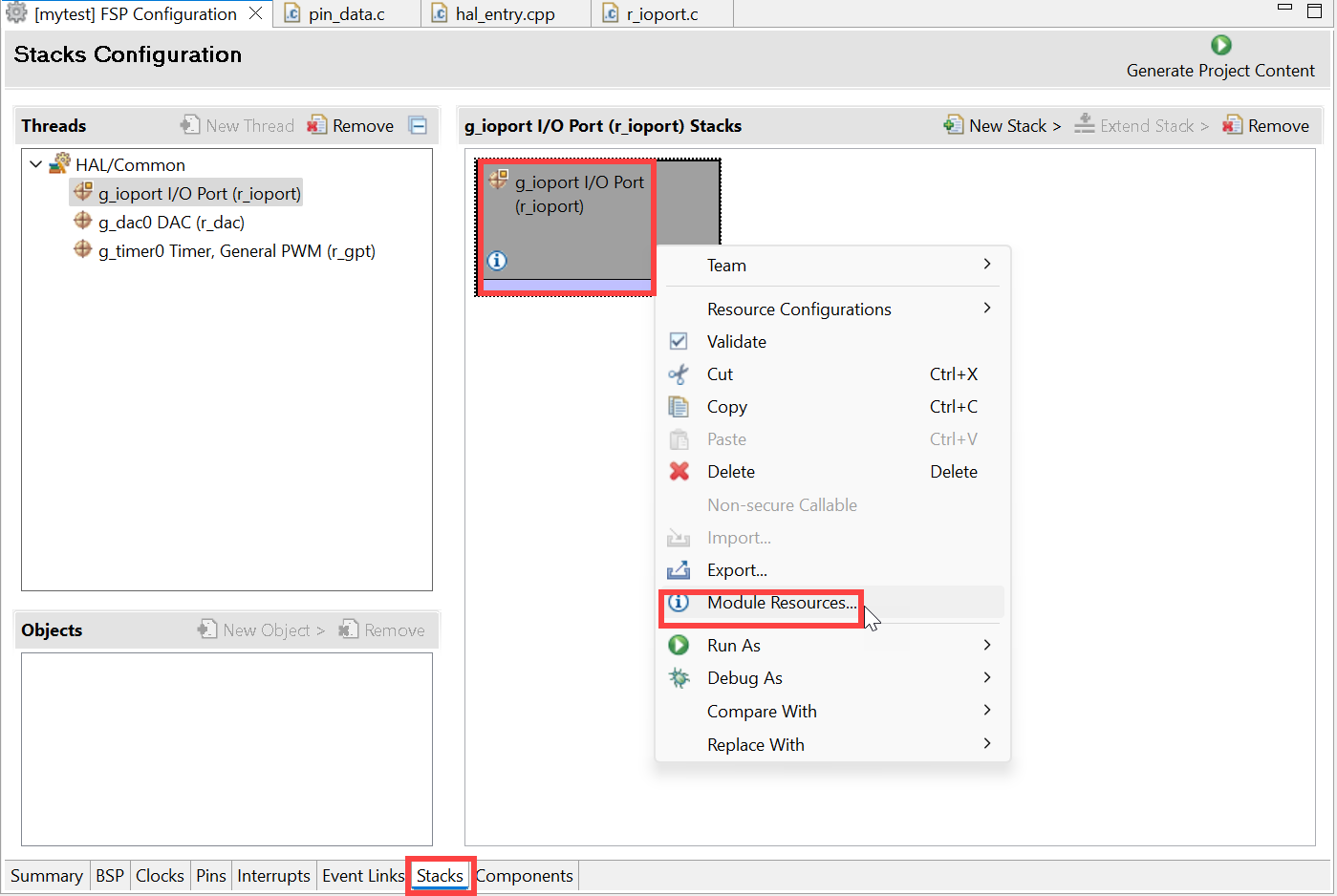

Double-click on configuration.xml in the Project Explorer, and then click on the FSP Configuration view to expand it. There are tabs labeled Summary, BSP, Clocks, Pins, etc. Select the Pins tab, and then choose the pin to modify. Since the development board has an LED connected to P106, I expanded port P1 and selected P106, and then set the mode to Output, and the Drive Capability to Medium. Click Save, and then click Generate Project Content.
If you click on the Stacks tab, you’ll see the following:
Selecting the g_ioport (r_ioport) box that is there and right-clicking, and then clicking on Module Resources, as shown in the screenshot above, will open up web documentation that explains it. Scrolling down that web page provides the example code to control GPIO.
Another way of getting to that documentation is to simply go to the Renesas FSP web documentation link and then, in the search box at the right side, type r_ioport  (r_ioport was displayed in the box in the Stacks tab screenshot earlier) and press Enter.
Again, you’ll find the same example code if you scroll down at that page.

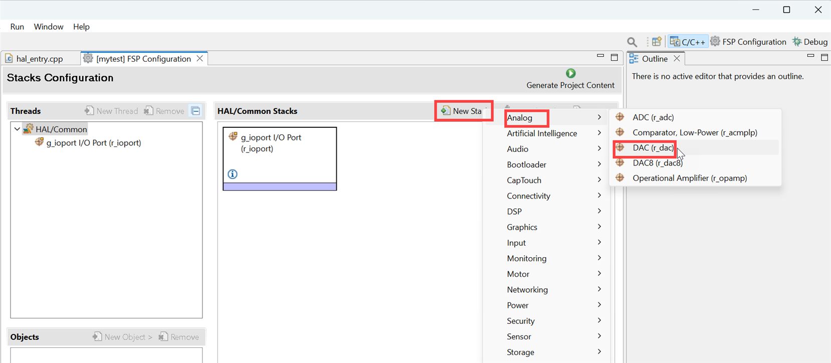

Adding a DAC to the Project

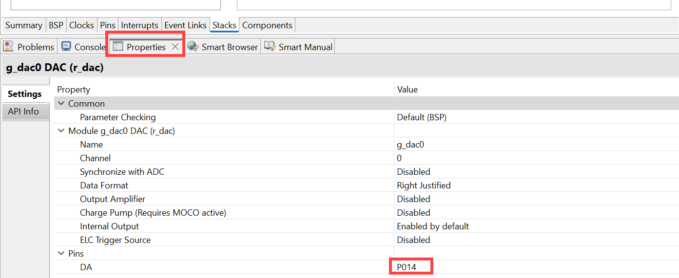

The DAC pin can be configured using the FSP Configuration’s Pins tab:
The FSP Configuration’s Stacks tab is used to add drivers.
Once you do that, click on the box in the HAL/Common Stacks pane, and then the tab for Properties for it can be selected below. Ensure that the pin configured in the Pins tab is visible, as shown in the screenshot below.
Save the configuration and click on Generate Code.
The easiest way to find out how to use the DAC is to navigate to the FSP online documentation and then type DAC in the search box on the right side.
Scroll down, and there’s a nice example.
Note that the example uses variables called g_dac_ctrl and g_dac_cfg, but the Properties pane in the screenshot above shows that the assigned name is g_dac0. Therefore the variable names in the example code would need to be modified to g_dac0_ctrl and g_dac0_cfg.
Then, to use the DAC in the code, the following line will enable it:
R_DAC_Open(&g_dac0_ctrl, &g_dac0_cfg);
To write a value v (between 0 and 4095, corresponding to between 0V and 3.3V) to the DAC, use these lines of code:
R_DAC_Write(&g_dac0_ctrl, v);

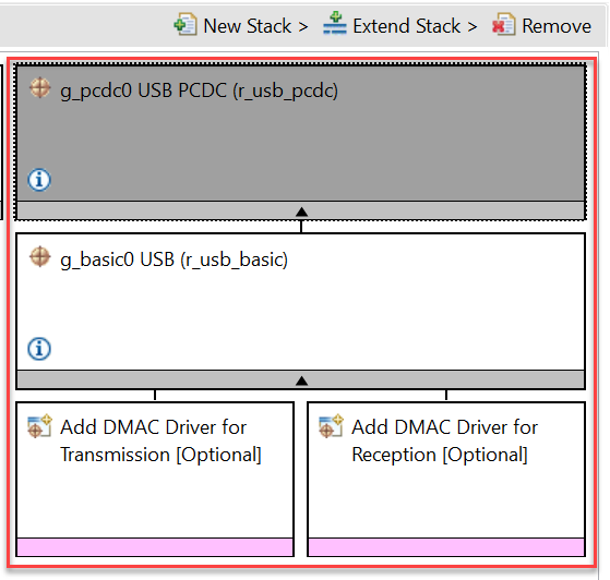

Adding USB Serial to the Project
USB Serial is extremely useful, since it can be used for printing troubleshooting messages to any connected PC or for displaying user menus and configuring applications.
Adding USB Serial is a little more involved than the other peripherals added to the project so far, but that’s to be expected since USB is more complicated. It’s not too bad, however.

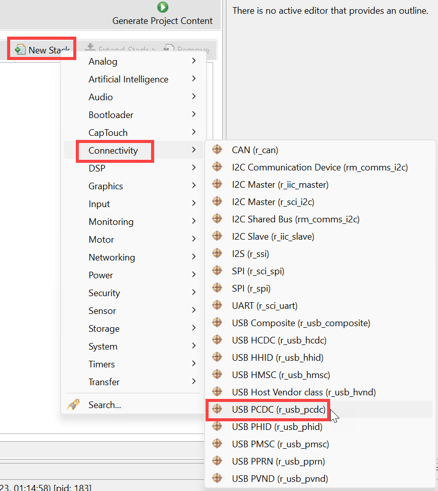

First off, as with other peripherals that have been added, double-click on configuration.xml to open up the FSP Configuration window, and then click on New Stack, and this time click on Connectivity and choose USB PCDC. PCDC refers to Peripheral Communication Device Class. The RA4M1 supports USB host or peripheral mode operation, but perhaps peripheral is the most expected scenario for typical microcontroller projects. CDC provides USB Serial functionality with no drivers required for connected PCs.
A load of blocks will be displayed in the Stacks pane:
Next, click on the Pins tab, and navigate to the pin selection shown in the screenshot below. Set the Operation Mode to Device, and then the rest will automatically fill with the pin numbering detail. Nothing else needs to be changed once you have modified the Operation Mode.
As before, click Save, and then click Generate Project Content.

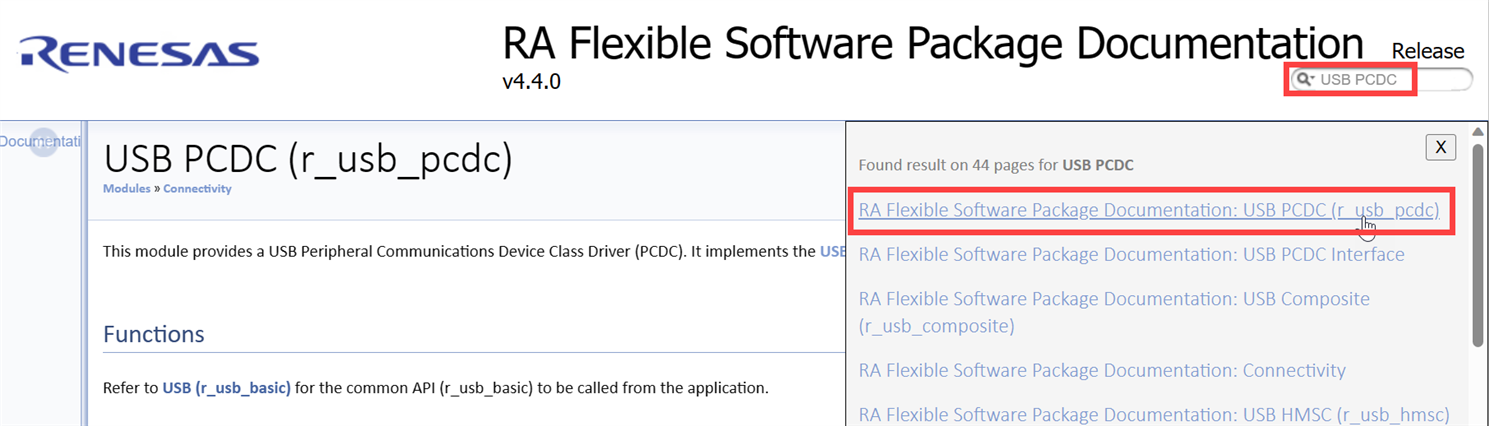

The online documentation for USB Peripheral CDC can be found by going to https://renesas.github.io/fsp/ and searching for it, as shown in the screenshot below.
According to that documentation page (scroll down to the end of that page), the code needs to include USB configuration structures, and an example template is supplied in a file called ra/fsp/src/r_usb_pcdc/r_usb_pcdc_descriptor.c.template
Go to that location and copy the content to the clipboard.

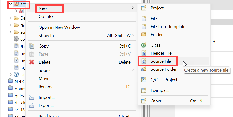

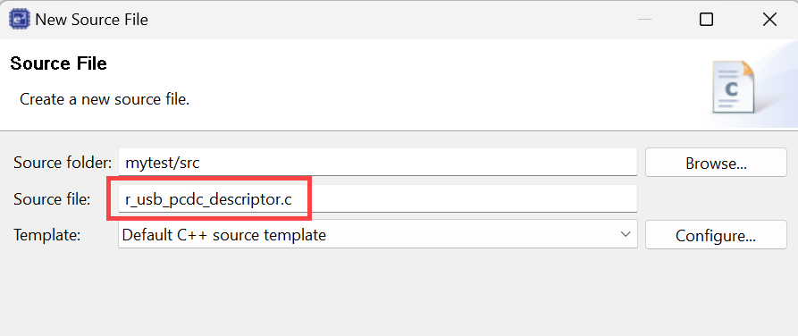

Next, create a new source file in the src folder, by right-clicking on the src folder and selecting New->Source File.
Give the new file the name r_usb_pcdc_descriptor.c
Paste the copied template content into the new file and save it. No other changes need to be made to the file.
