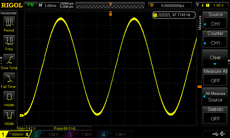

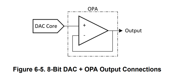

The source data for the DAC is an array of 256 samples of a sinus. One of the timers will tell DMA to copy the next value to the DAC's data register. The on-board OpAmp will buffer that data and expose it to pin 22, as an approx. 98 Hz sinus.
source: MSPM0 L-Series MCUs Hardware Development Guide

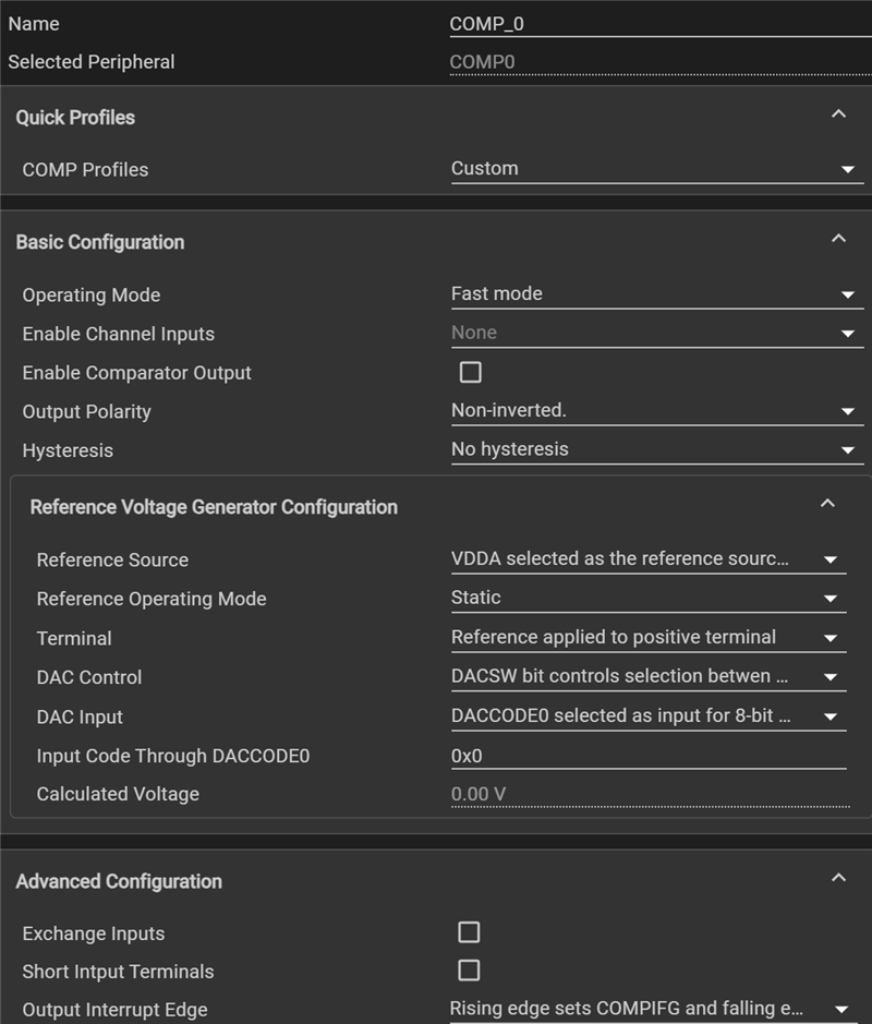

Because the DAC is part of the comparator peripheral, that comparator 'll be the object you configure:

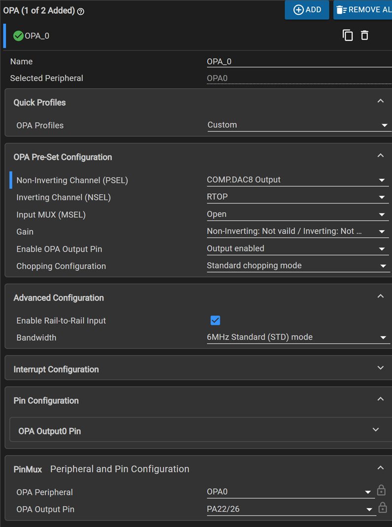

OpAmp is configured to buffer and expose the DAC signal:

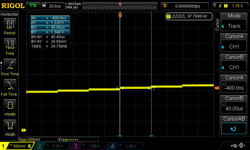

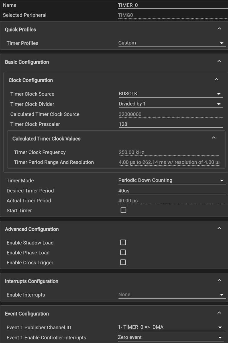

Timer is used to clock the move of the next sample. The 40 µs timer period drives the sinus frequency.
256 samples * 40 µs = 10240 µs -> 97.65625 Hz.
The MSPM0L uses an internal clock. This is not a crystal controlled frequency.
The DMA is then set up to transfer a table to a single destination, entry by entry (block to fixed):

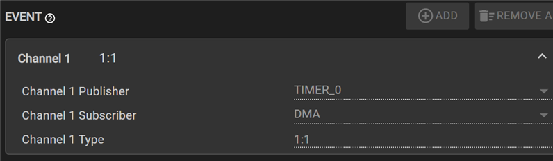

Last check, is to see the event handling
