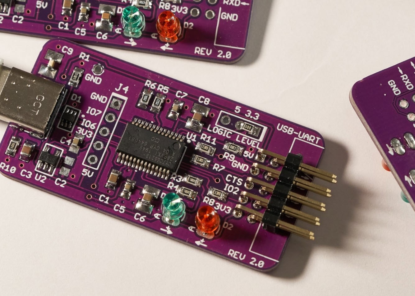

Reusing a USB UART Board
This project uses a USB UART board that is described here.  No changes were made to the board.
Alternatively, a ready-made Sparkfun board can be used.
Open Collector Outputs
The Cypress chip on the USB UART board has normal 3.3V logic outputs. I soldered up a couple of transistors to provide open collector outputs instead:
That’s it in terms of the hardware! The two open collector outputs labeled OUT6 and OUT7 can be wired to any reset or bootloader buttons on the development board.
