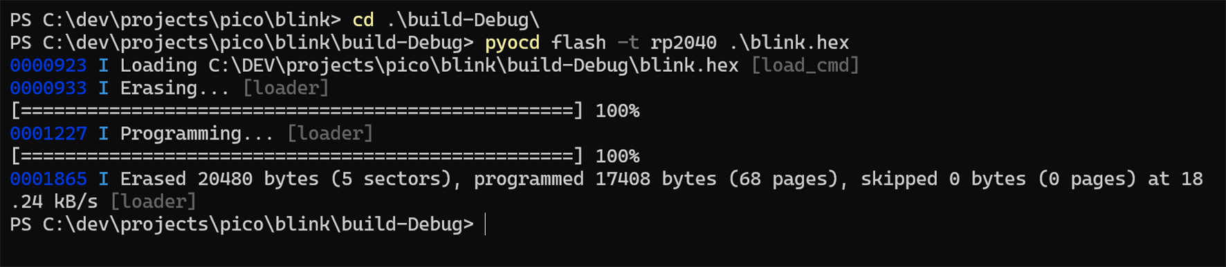

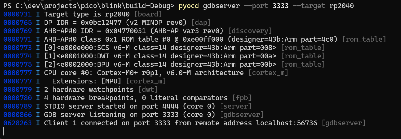

  • Using PyOCD

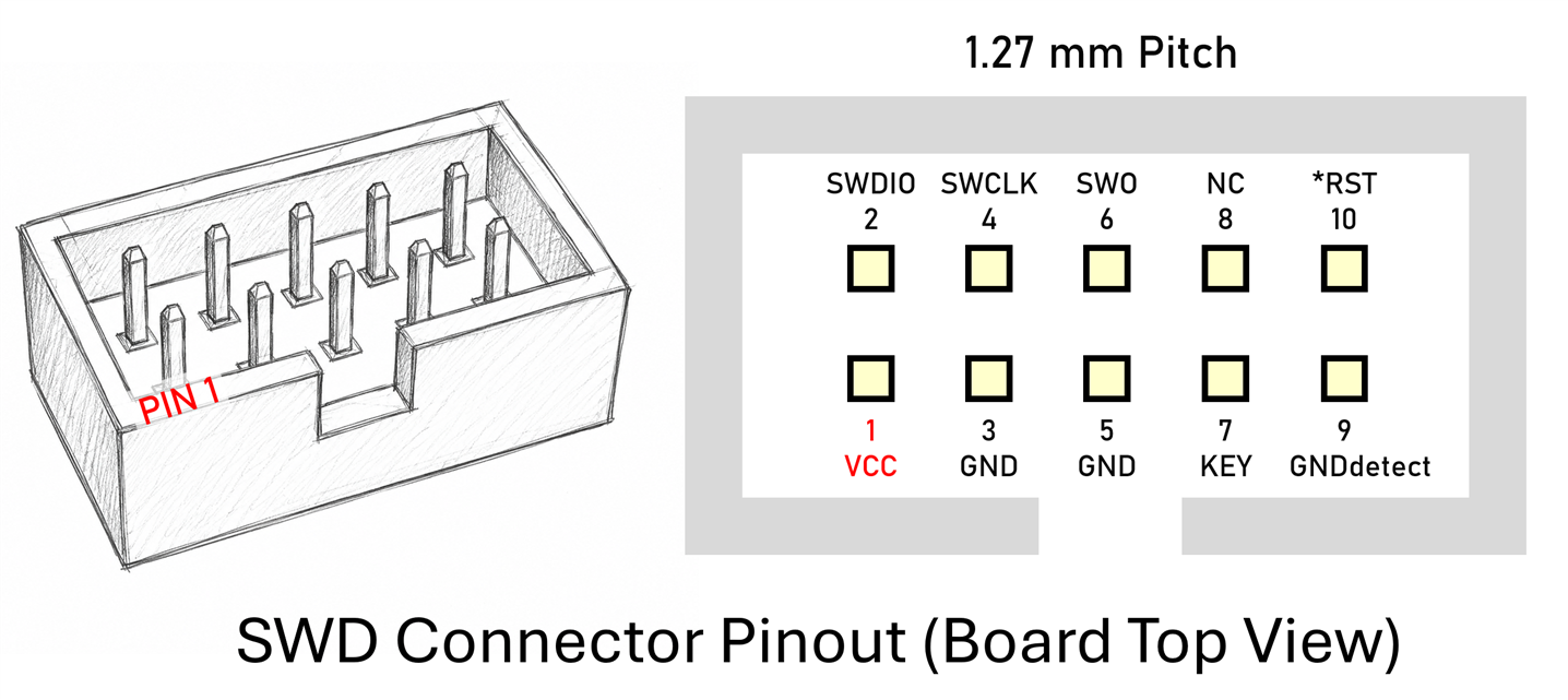

Board Connections
Ordinarily, a microcontroller board has a 10-pin connector on-board, or it may have a different connector labelled DEBUG or SWD. See the earlier diagrams for the pinout.
At a minimum, you’d connect the GND, SWDIO and SWCLK connections.
You may need to attach the nRST (*RST) wire too (it depends on the microcontroller, but it doesn’t hurt to attach it even if it was not essential).
Also, it’s very likely you need to attach a microcontroller supply rail to the VCC pin on the debug probe; that connection is used by the debug probe to set its internal level translators to match your microcontroller circuit. As mentioned earlier, some debug probes may default to 3.3V if that connection is not wired up, but you’d need to check the probe documentation.

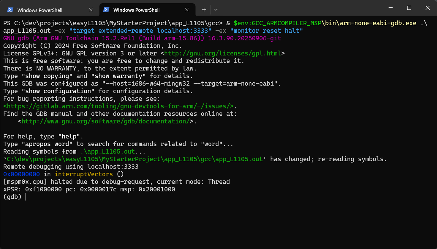

To use GDB from the command line with a microcontroller, usually OpenOCD is run first; in this example, I’ve just passed the board file as a command-line parameter:
\bin\openocd.exe -f .\share\openocd\scripts\board\easyL1105_cmsisdap.cfg
That command will result in OpenOCD opening up a port (3333) and listening for a connection from GDB.
In another window, GDB can be run; it is normally installed as part of the ARM GNU toolchain that contains the GCC compiler among other software development tools. If you’re using Windows PowerShell, you’ll need to type a command similar to:
& $env:GCC_ARMCOMPILER_MSP\bin\arm-none-eabi-gdb.exe .\app_L1105.out -ex "target extended-remote localhost:3333" -ex "monitor reset halt"
What that command is doing, is running GDB and instructing it to connect to OpenOCD, and then pass a reset halt command to OpenOCD, which (obviously) causes the target microcontroller to reset, and then halt as soon as possible (before the main() function executes).
After that, you can type various commands at the (gdb) prompt.

As an example, the screenshot below shows GDB being used to show the disassembly of a main function in some code:

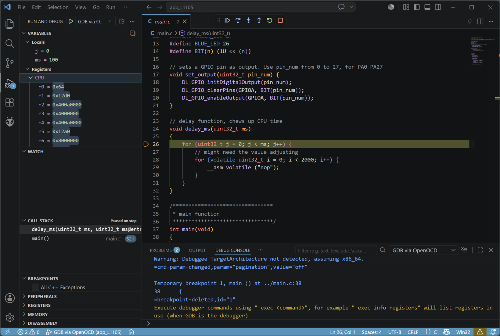

Using the Debugger in VS Code
The excellent VS Code has a graphical interface and it can run GDB. To use it, first ensure that a VS Code extension called cpptools is installed.
You’ll need to create a file called .vscode/launch.json from your project folder. It will need to look something like this:
  "version": "0.2.0",
  "configurations": [
      "name": "GDB via OpenOCD",
      "type": "cppdbg",
      "request": "launch",
      "program": "${workspaceFolder}/gcc/app_L1105.out",
      "cwd": "${workspaceFolder}",
      "MIMode": "gdb",
      "miDebuggerPath": "${env:GCC_ARMCOMPILER_MSP}/bin/arm-none-eabi-gdb.exe",
      "setupCommands": [
        { "text": "file \"${workspaceFolder}/gcc/app_L1105.out\"" },
        { "text": "target extended-remote localhost:3333" },
        { "text": "monitor reset halt" },
        { "text": "tbreak *main" }
      "externalConsole": false
      "name": "GDB with Load via OpenOCD",
      "type": "cppdbg",
      "MIMode": "gdb",
      "setupCommands": [
        { "text": "load" },
In brief, that file contains two configurations, both of which have type cppdbg which are associated with the cpptools extension. The extension will launch the GDB debugger in the background for you, however, OpenOCD still needs to be run manually (this could be automated, but it’s easier to just do it manually):
C:\dev\tools\openocd_mspm0\bin\openocd.exe -f C:\dev\tools\openocd_mspm0\share\openocd\scripts\board\easyL1105_cmsisdap.cfg
Use Open Folder to view the project source code in VS Code, and then when you’re ready to debug, press Ctrl-Shift-D and you’ll see the configuration listed alongside a green run triangle, to the left of the code pane. Click the triangle, then after some seconds, the view should display the code halted at the main breakpoint. There are buttons at the top to continue running or step into functions, and so on. Variables are listed on the left.

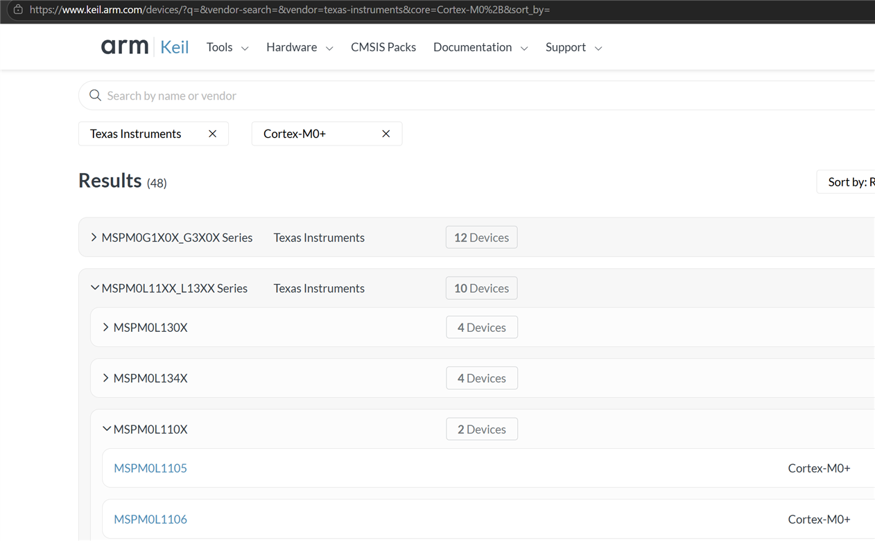

A nice improvement from OpenOCD is that PyOCD relies on CMSIS Device Family Packs (DFPs) which are available for almost every ARM Cortex-M microcontroller, and you can usually just refer to the microcontroller part code to find what you need to type.
You can search for the pack on the ARM website as shown in the screenshot above, or, alternatively, simply let PyOCD search and install it (the first time it takes several minutes while it processes an index):

Now the microcontroller can be programmed using a command such as:
pyocd flash --target rp2040 .\blink.hex

Then, on a command line, start up PyOCD:
pyocd gdbserver --port 3333 --target rp2040
Now, just as mentioned in the earlier section, in VS Code, press Ctrl-Shift-D and then click on the green debug triangle. The above example assumes that the debug build code has been flashed into the microcontroller beforehand, using (say) the pyocd flash command as already discussed.
