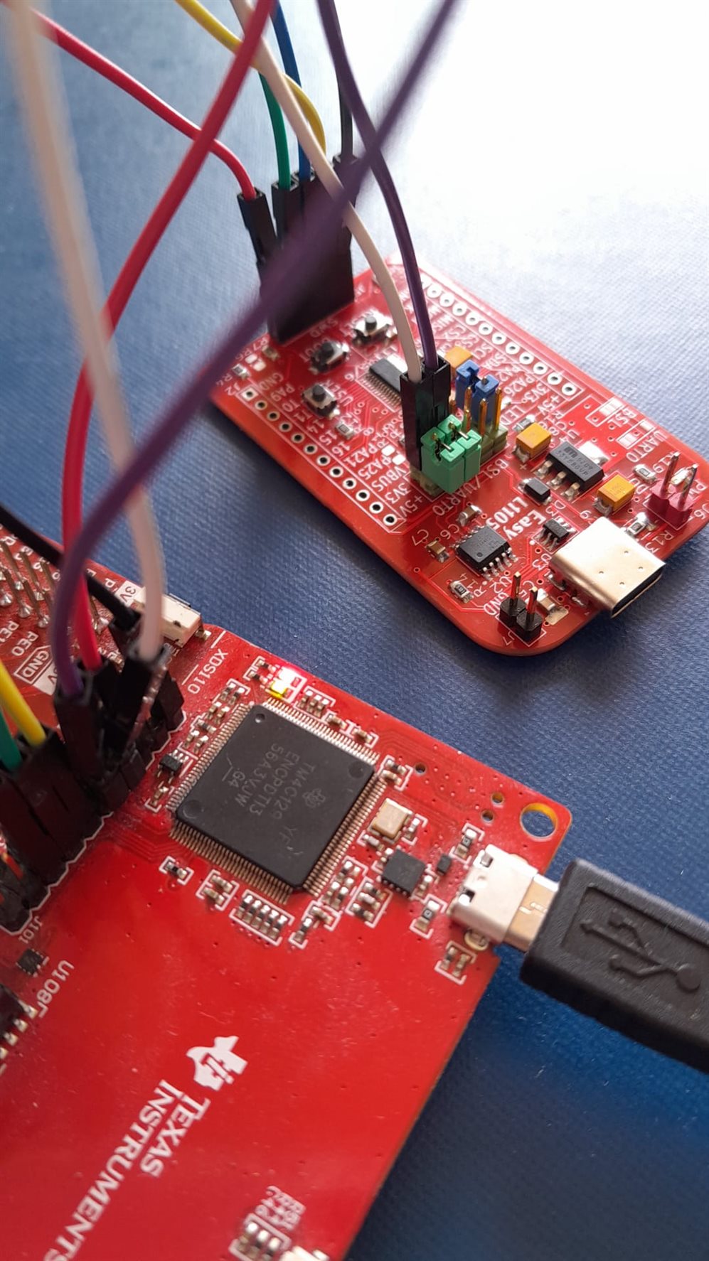

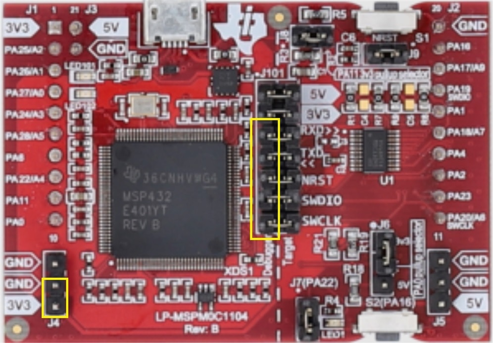

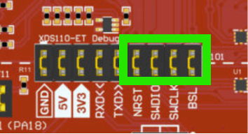

Remove all jumpers from the EasyL1105. And all (at least the debugger) jumpers of your LaunchPad.
Then connect the two, using patch wires:
EasyL1105 LaunchPad
J5.1 GND GND
J5.2 RST RST
J5.3 SWCLK TCK
J5.4 SWDIO TMS
J5.5 3V3 3V3
J3.2 UART0_RXD RXD*
J3.4 UART0_TXD TXD*
*on the LaunchPad jumpers, the TXd and RXd are labeled for the controller side signal. So no Rx/Tx crossing.
On the cheap LP-MSPM0C1104, here are those signals:
On the MSP432 LP that I'm using, it's very similar. The table above will guide you through the setup.
Double check, then connect the LaunchPad USB to your PC.

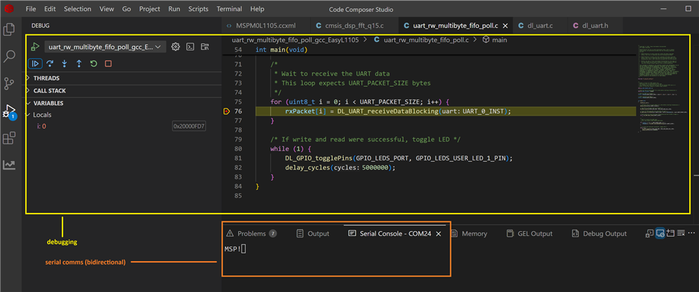

Start debugging in ccstudio
Click on your MSPM01105 project. Then call menu Run -> Debug Project (your project name). If this is your first debug attempt, ccstudio will show a debug configuration screen.

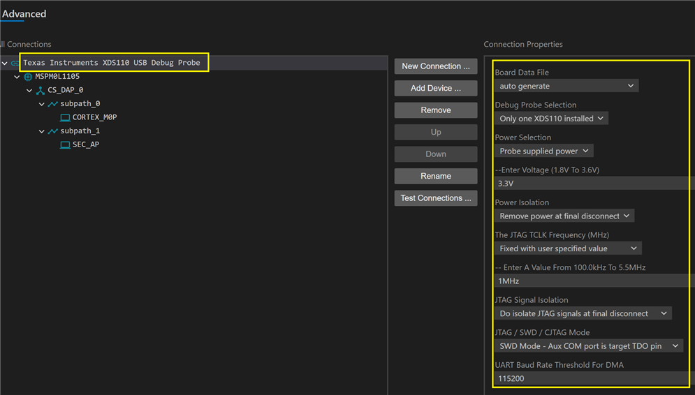

On the Basic tab, select debugger XDS110. The MSPM01105 controller should already be correctly selected.
On the advanced tab, select on the root node of the tree. Take over the settings from the image below:
If you haven't used your LaunchPad for ages, ccstudio may upgrade its debugger firmware. After that, you should be in business.
Use UART
To connect to the MSPM0 UART, open a serial console via View -> Console -> Serial Console. Open the COM port representing the passthrough (the one named XDS110 Class Application/User UART in your Windows device manager).
Most SDK examples use 9600 baud, 8, N 1.
Happy debugging.

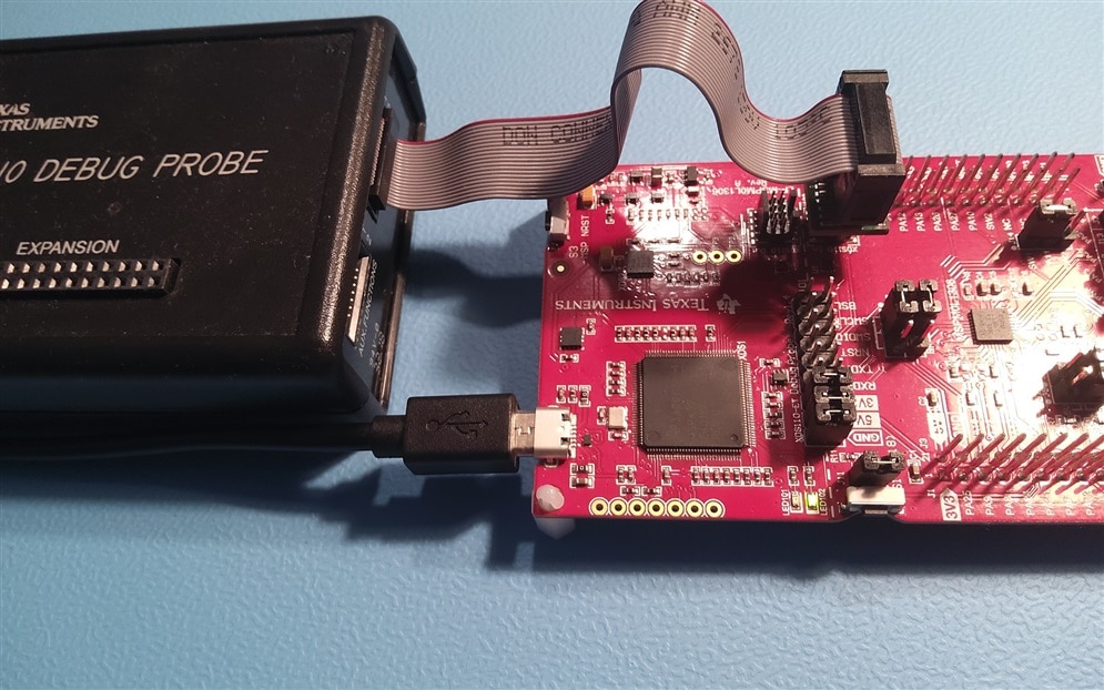

    You can also do the opposite of what's described in this post: program the LaunchPad with an external debugger.
    Several of the MSPM0 LaunchPads have 2 ARM 10-pin JTAG connectors. One so that you can use the LaunchPad to program other devices.
    The other one allows to connect an external debugger. In the photo below, I use a TI XDS110 debug probe.
    In both uses cases, you have to remove the debug bridge jumpers in the middle of the board, to break the connection between the on-board debugger and the MSPM0.
