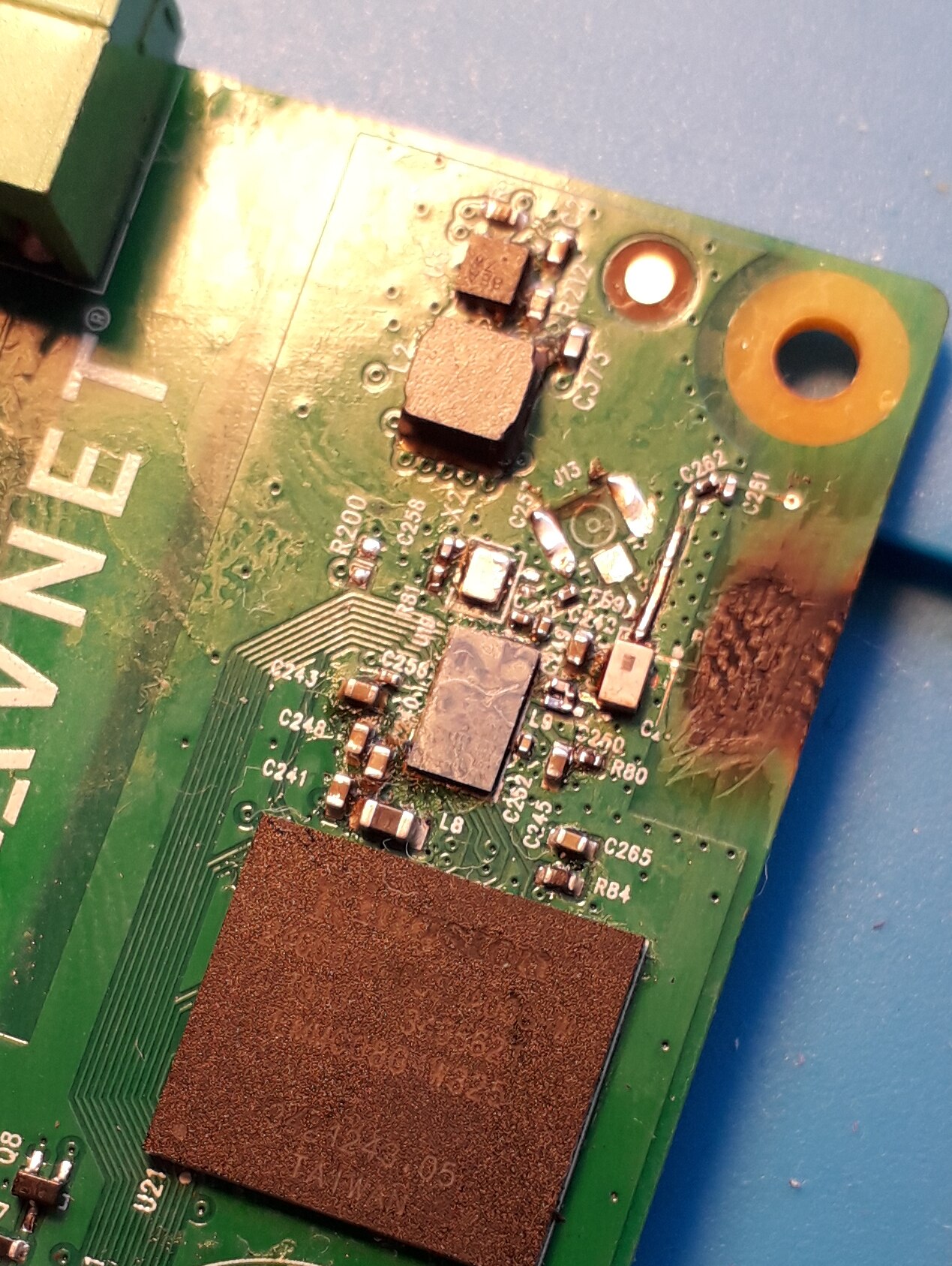

Modifications don't always go right.
Yesterday morning I tried to replace the PCB WiFi / BT antenna on a Avnet SmartEdge with an external one.
I had to place a fitting connector on a footprint and turn a resistor 90° to route the signal to it.
I got he connector off a launchpad that's no longer supported.
That wasn't hard, although it took a decent time to heat up the big ground plane.
The drama occurred when I tried to unsolder the tiny resistor with a hot air pencil.
The trace between the lower side of the resistor and the ceramic filter FL1 underneath it ripped off completely.
Various attempts to try and scrape a little bit of track from under the filter failed. So I had to remove it with hot air.
Then try to create my own little trace from underneath it.
Long story short, it didn't work.
I managed to restore all electronic connections (I buzzed everything through, but never got a BT or WiFi signal out).
I also tied to restore the original route with a tiny patch wire made with a transformer (enamel tactically removed at the right spots) wire.
It never worked again.
Tried this morning with fresh energy - and daylight - but again no success.
As you can see, my very last attempt - when I knew it was a lost case but gave it a shot anyway - turned the part of the board where the PCB antenna is, charred.
Officially not fixable anymore, I adapted the overlay to disable wifi and BT. I'm using wired network now.
On the + side, it gives me a chance to show you the underside of the PCB:

    There is nothing going through the ICs when measuring. I am (was in this case image ) probing after any active device and the meter is isolated.

    Is it safe to buzz out an antenna path? Those seem like they might be sensitive to DC if anything isn't actually shorted, or if testing for a short to ground.
