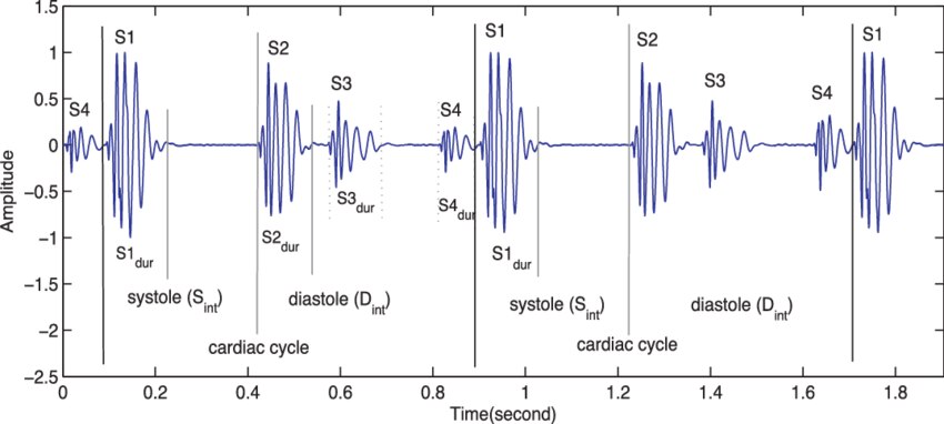

I would like to built a heart beat sensor (note: no, it is not an ECG) that sense the sound made from the heart (phonocardiography) and converts it in a digital signal.
I am writing here for suggestion about how to achieve it.
I did a little bit of researches and found that a heart beat should be around 10-15dB (source: The Decibel ). Actually an heart beat is made by 4 different sounds so i guess that the article refers to the most audible (S1) so for my application I think that would be good to aim at around 5dB.

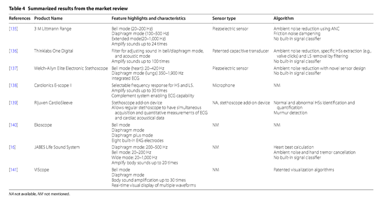

    I thought that a piezo was something not very good for this, but i shall reconsider this, I just found an interesting table that shows that some of the most important stethoscopes (3M) is actually using…

    I thought that a piezo was something not very good for this, but i shall reconsider this, I just found an interesting table that shows that some of the most important stethoscopes (3M) is actually using it.
