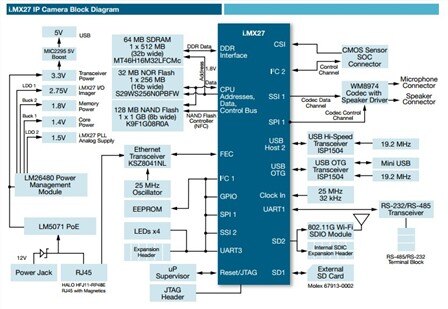

    If you expect video high resolution and framerate which means video encoding, I would recommend an ARM Processor type ARM9 or ARM Cortex-A rather than an ARM Microcontroller type Cortex-Mx.
    Please find below the picture from a Freescale reference design from an IP Camera based on an i.MX27 (ARM9 processor @400MHz).
    More information with pdf below
    imageIPCAMREFDESFS.pdf
