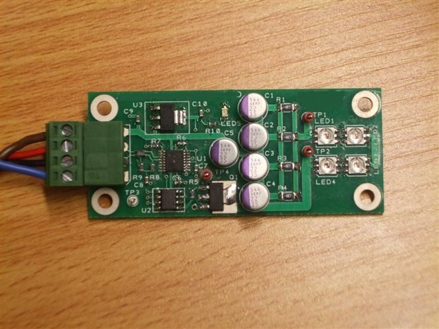

I'm looking for high speed (slew rate), high current op-amps. I'm aware of the external typologies that can be added to op-amps to increase the output current capability, but the component count starts to become daunting for my application. I'm trying to design a circuit to produce up to a 1.5 Amp current pulse to an optical device. The pulse will vary in width from 100 ns to 1000 ns depending upon the application. Rise/Fall less than 10 ns. I've been googling for a bit, and it seems to be exclusive. You can get either the high current, or the high slew rate. Any options would be great.

    Rise/fall in 10nS = slew rate 150A/uS and certainly no less than 200V/uS - I was about to say I didn't think you would find one when I remembered Apex:
    May be out of your price range but their  PA09 does 200v/us, 150 MHz bandiwdth - no pulse diagrams on the data sheet.
    They do lots of other parts so take a look: www.apexanalog.com
    How well do you need to control the current and pulse shape ?
    MK

    This'll be quite hard - up to 1.5A in 10ns and nice and clean - means short wires between load and power device, very low impedance supplies.
    Check out this (Linear technology APP Note 133)
    www.linear.com/docs/40550
    Jim Williams is only aiming for a much slower rise time and single quadrant drive but at higher current - note well the section "Layout Effects".
    About the simplest way to get close (which oddly I've just done for someone) is to uses a MOSFET with proper MOSFET driver and control the current by having some series resistance and an adjustable;e power supply. My circuit (in the picture) has 1.175R series resistance, 5 low ESR 22uF caps in parallel, and 10R in series with the MSOFET gate - rise time to 2A is about 35nS. I've got another one to build and test so if I get time I'll try without the 10R and take some scope pictures. It would probably work better with the MOSFET closer to the LEDs. I'd like to get the max current up to 5A.image
    This board is at the end of 3M of cable (single twisted pair with two additional power cores) and uses LVDS TX and RX chips to get the control pulses up the wire. The power regulator at the source end of the cable can do about 4-14V. The load is 4 red LEDs in series (it's a strobe light but I can't tell you what its for.)
    If I needed to get current out of the load fast I'd add another MOSFET (P) to short it the load out (and worry about how to stop them both being on at once !).
    MK
