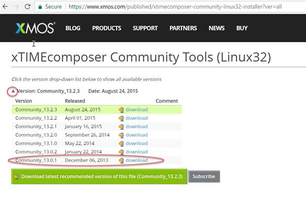

    where can I get Version 13.0.1? I don't see it on there web site. I need
    the 32-bit version for Linux.
    Thank You

    0 shabaz over 9 years ago in reply to rhinerfeldnyc
    Hi Richard,
    The small triangle (shown circled below) needs to be clicked on, to see the older versions.

  • rhinerfeldnyc
    0 rhinerfeldnyc over 9 years ago in reply to shabaz
    what triangle?
    All those versions are not there except 13.23
    I have only USB 2.0 ports!
