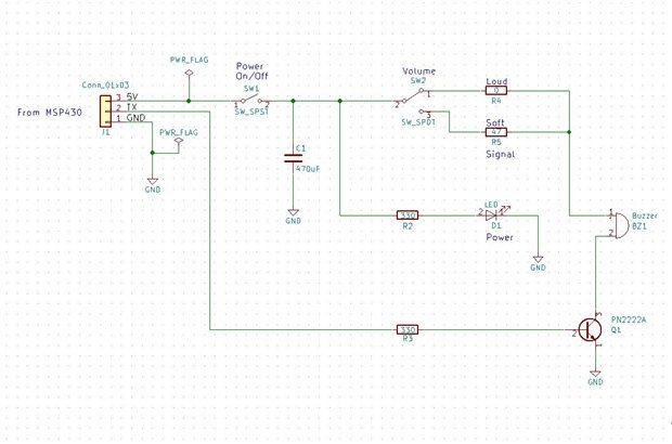

I am working on a gizmo that will alert the user to an event using sound and light.  It will be in a small enclosure.  My objective is to make the buzzer as loud and annoying as possible, with an option to soften it. This is what I have to work with power wise:
  • 5V from USB
  • 3V logic from microcontroller
  • gizmo will include a radio so want to avoid a switching boost converter
I put together the following circuit on a breadboard which works more or less as expected:
I don't need to vary pitch and the buzzer I just happened to have on hand is an active buzzer (that is to say it will buzz with only DC) which frees up a timer on the microcontroller.  I have looked through the E14 offerings and 85 dB seems to be about the best I can expect at 5V.  Before I blindly pick one and move on here are my observations and questions:
1) There is a sharp transition between loud and soft.  It seems subjectively like it goes from a soft buzz to full throttle with a small change in R5 on the schematic.
2) Are there high efficiency buzzers I am missing or is the only way to get higher volume with higher power and thus, higher voltage.
3) I might consider an amplifier with speaker but it would have to be simple, sturdy, and compact.
Thoughts and ideas are greatly appreciated!

    Piezo buzzers will provide higher sound pressure level with lower input power than magnetic buzzers. The input power is minimized and the output sound pressure level is maximized when the buzzer is operating…

    Another option could be to do something mechanical to provide better impedance-matching of the buzzer to the air: essentially some way to make the buzzer move air more efficiently. Some kind of waveguide…

    Hi Frank, Interesting topic I've looked in the past for good buzzer circuits too, and it seems quite hard to find an off-the-shelf single chip to do this these days. One trick I recall was to use a schmitt…

    I doubt if it will make much difference but you can squeeze an extra volt into the Buzzer if you use an N Channel MOSFET  instead of the NPN Transistor. Depending on how you are driving the transistor it may work without modification or you may need a 10K resistor to pull the gate to ground.

    Hi John,
    I am a retired mechanical engineer and still learning electronics so much appreciated.   I have been using bipolar transistors up until now for the most part but did get some BS170 N-Channel MOSFETs a while back.   I will probably be driving the transistor with a MSP430 at ~3 V.  No problem putting a 10K pull-down resistor on the gate if needed and will keep that in mind.  I note from the datasheet that the BS170 has very low Drain-Source current with Vgs of 3V.  Assuming I am reading this right, it would be a poor choice.  I will have a look through what is available but suggestions are welcome.

    Hi Frank,
    I have traditionally used an NTD 4906 for these applications as they are logic level and will saturate by 3 volts. I just set up a test with 5 volts on my load to the drain of an NTD4906 and I was able to get full saturation at 2.9 volts under a 750 mA load.
    There should be some equivalent N ch MOSFETS out there as these are listed as obsolete now. The trick will be to make sure they will handle the current of the buzzer and that they are specified as "logic level" or have a Vth low enough to work.

    I took a look at the BS170 data sheet and its Vgsth is slightly higher than the NTD4906 but the big short coming is that at full saturation it has a much higher DS resistance.

    Piezo buzzers will provide higher sound pressure level with lower input power than magnetic buzzers. The input power is minimized and the output sound pressure level is maximized when the buzzer is operating at its resonant frequency.
    You can get 125 dB with 200 mA if you really want it that loud.
    A PUI (AI-5025-TWT-R) generates 115 dB with 75 mA at 12 V.
    At 5V you can get 95 dB with 5 mA. (Mallory PT-3529PQ).
    You can put several in parallel if you want louder sound.

    Another option could be to do something mechanical to provide better impedance-matching of the buzzer to the air: essentially some way to make the buzzer move air more efficiently. Some kind of waveguide (like you get for bass on ported music speakers) can work well. Your frequencies won't be low, so the waveguide won't be large.... but you need some way to design it.
    As dougw said, because your frequency is fixed, resonance will help you. Attaching the buzzer to another, larger, object that has the same resonant frequency can help you get more air moving (so higher SPL).

    Interesting topic image I've looked in the past for good buzzer circuits too, and it seems quite hard to find an off-the-shelf single chip to do this these days. One trick I recall was to use a schmitt hex inverter or quad NAND integrated circuit, and parallel up some of them for drive, and put the piezo buzzer across it, so that it is in parallel too, for doubled-up Vp-p. It would be possible to use one of the gates for an RC oscillator.

    Good point dr-jhc . A horn shape is likely the best way to match impedance, although which horn shape is best, is a complicated question.
