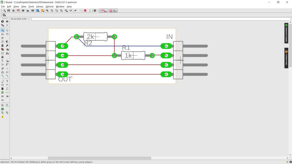

I am creating a project that uses a Raspberry Pi Zero W and an ultrasonic distance measuring device (HC-SR04).  I have the code done, but now I want to move from the motherboard to a small PCB that will let me hook up the tester quickly.
Here is a layout I pulled from the web that shows the need to split the signal back to ground to 3.3 volts do it doesn't fry the Pi.
So I took a stab a designing my first PCB using Autodesk eagle.  It was a struggle, but I think I got it done.  Here is a screenshot of the finished board
On one side I have the pins to match the Ultrasonic-module (IN) and one set of pins to go to the PI (OUT).  I am using a 1K AND 2K resistor on the advice of another post to split the signal back.  Before I send this out to get a PCP bid, can someone with vastly more knowledge than I look it over quickly and make sure this is correct according to the layout above.  I am working on a silkscreen layer for the pins on both sides to help with hookup, but right now I just need to know if I am on the right track.

    genebren over 8 years ago +3 verified
    John, Your PCB looks OK. I say this not completely understanding which pins on your 'IN' and 'OUT' are assigned to. Just guessing at this point but the 'OUT' side looks like Ground, Echo, +5v or Trigger…

    Yes the in side will match up (from the bottom up) +5V, Trigger, Echo, Ground coming from the ultrasonic tester. The out side will be 5V from the pi, GPIO PIN, GPIO PIN, Ground. The GPIO pins will vary…

    John,
    Your PCB looks OK.  I say this not completely understanding which pins on your 'IN' and 'OUT' are assigned to.  Just guessing at this point but the 'OUT' side looks like Ground, Echo, +5v or Trigger and +5v or Trigger (top to bottom).  On the 'IN' side it looks like Ground, GPIO24, +5v or GPIO23 and +5v or GPIO23 (again, top to bottom).  If these are correct, then I would say that you PCB looks fine.
    Good luck,
    Gene

    Yes the in side will match up (from the bottom up) +5V, Trigger, Echo, Ground coming from the ultrasonic tester.  The out side will be 5V from the pi, GPIO PIN, GPIO PIN, Ground.  The GPIO pins will vary depending on what I use.  The example I pulled down used pin 23 and 24 as an example.  I am working on a silkscreen on the pins for clarity, and then I will look for a PCB company to make one up so I can test it.

    Hi John,
    just wondering, making a PCB for such a small circuit seems to be a lot of work. I would just use piece of Veroboard (aka stripboard) ...

    The HC-SR04 states it is TTL and runs on 5V.
    I presume that you can drive the trigger pin using the 3v3.
    The alternative way to convert levels is these little things which can drive 220mA continuous or 880mA pulsed.
    https://www.sparkfun.com/products/12009
    Sparkfun are just one supplier.
    The above is 4 of them on a board, but you can buy the BSS138 devices on their own.
    https://cdn.sparkfun.com/datasheets/BreakoutBoards/BSS138.pdf
    In your application the LV would be 3v3 and the HV would be 5v.
