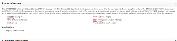

  • richoxski
    0 richoxski over 7 years ago in reply to michaelkellett
    Hi Michael,
    I am going from the datasheet
    Link below
    http://www.farnell.com/datasheets/1671831.pdf
    Same information given in the product link below
    https://au.element14.com/stmicroelectronics/stm32f4dis-lcd/module-3-5inch-lcd-f4-discovery/dp/2250207
    I am not sure if the product has changed, but as far as my knowledge goes these features are included
    Thanks
    Rich
  • michaelkellett
    0 michaelkellett over 7 years ago in reply to richoxski
    This is confusing !
    The Farnell datasheet is useless - no schematic.
    Googling for schematics finds them in odd places.
    The LCD connector on the main board doesn't quite match with the LCD display.
    I've attached the .pdfs I found.
    I agree that the 2 page flyer on the board set talks about about the display having the driver IC ??
    My guess is that they made more than one - can you get a schematic of the display baord you have (and does it have the SSD2119 vivisble)
    If it does have the SSD2119 you should be able to drive it.
    MK

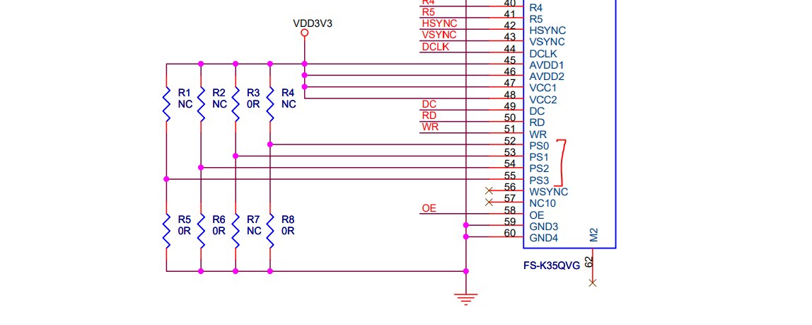

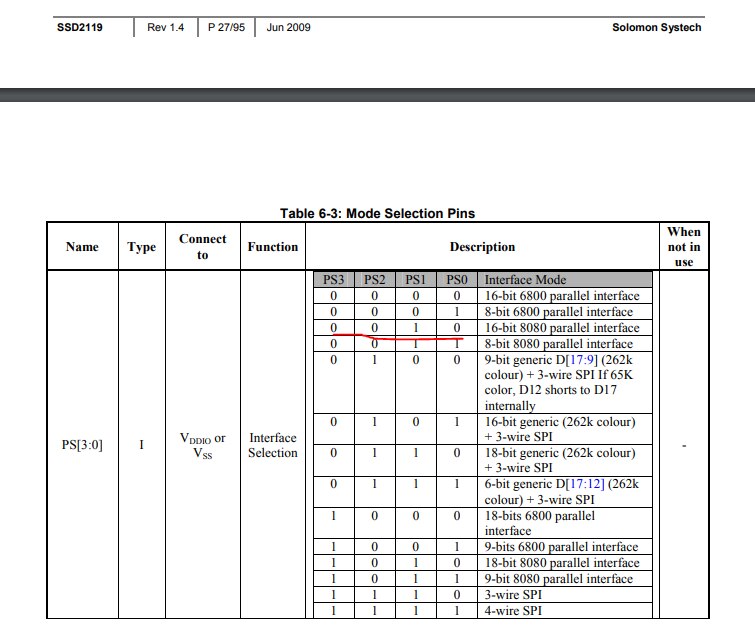

  • richoxski
    These are the same schematics I was able to retrieve
    Agree, the 20 pin DIP on the LCD schematic you have provided is quite confusing.
    It highlights both RGB and 8080 interface pins
    However, the other connector on this schematic has 4 pins PS[0:3]
    These pins match the mode selector pins for the SSD2119 - specifically for a 16 bit 8080 parallel interface
    Cheers

  • michaelkellett
    I think you may be right - I was thrown by them labeling the data pins as R,G, B.
    Have you tried running (or looking at) the example code - it would be worth looking at it because it is very hard to work out all the settings for the display controller.
    Bit banging could work - you'll need to be careful with timing - GPIO pins set for max speed to try to meet that 4ns max rise and fall time but watch out for some of the min times which the processor can easily beat.

  • jc2048
    0 jc2048 over 7 years ago in reply to richoxski
    You'd need to wire power and SPI lines across to the module from the processor board. You'd also have to rearrange the mode selection resistors so that it started in the right mode (moving R5 resistor to R1 placement and R6 resistor to R2 placement would get you the SPI 3-wire mode).
    But, given that you'd then have to also rework a whole lot of code to drive it, it would probably be much simpler, as you've already said, for you to use the processor board that the module was intended for.
