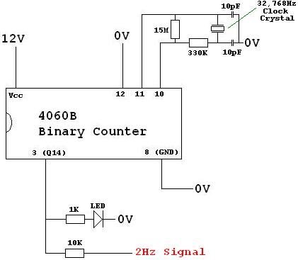

Hi - I need a low power timer which will produce a 1 second pulse or a 1Hz square wave with an accuracy of better than 0.1% over a range 0 to 30 degees C.  Can anyone suggest a chip or module or circuit or application note that will provide this? Thanks Dave Tedd. image

    Hi, I would go for the venerable '4060 and a 32768Hz resonator. You have to add a F/F to get 2^15 division ratio. Accuracy is limited mainly by resonator, so 1000ppm is easily met.

    Hi Thanks for that -have ordered the bits and will let you know how I get on.
