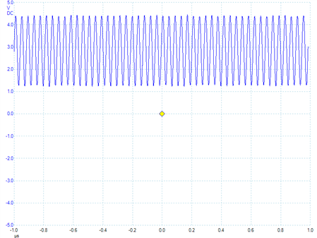

I believe I should be getting clk/4 out on the OSC2 (pin 40) -  but it is idle, and the pins on PORTA are not toggling, so I don't think the clock config is correct.
Can anyone see why this simple project isn't working ?
I have the required capacitors on the VDDCORE pin and ENVREG is tied to VDD (3.3v)
For the curious, here is a screen dump of the clock on pin OSC1

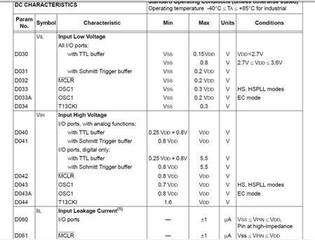

    Have you tried using an external generator with a square wave using a 0v ~ 3.3V signal level?  Your clock signal in the image seems to be floating too high above ground (perhaps?).   <just a thought>

    0 KennyMillar over 15 years ago in reply to gbrettell
    Thanks that was good advice.
    Indeed I slowed my clock generator down to 2MHz and was getting a lovely squarwave which did drop to 0v, but it made no difference.
    I have however found the problem - this device requires a pullup on MCLR which previous pics I had used did not.
    I've added this pull up and now it works beautifully at 25Mhz with the clock shown above.
