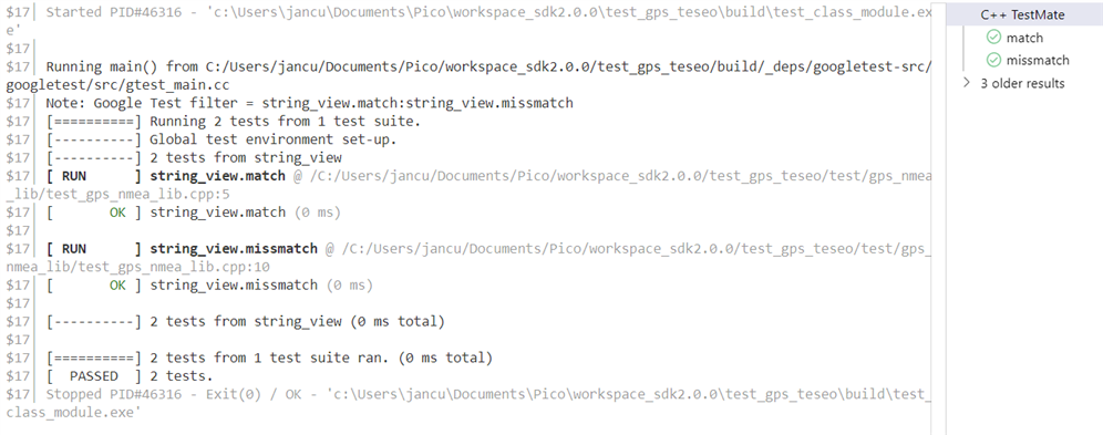

This week I'm going to learn GoogleTest for c++. I used JUnit frequently during my Java days. But never used a unit test framework (or unit tests) for embedded development.
Goals for the first days, done in  Try out GoogleTest
  • able to run a GoogleTest
  • build a CMake script that does everything
  • integrate with VSCode
and, in this post
  • test some custom code: a class in a C++ module

Test Suite
// test_suite.cpp
#include <gtest/gtest.h>
import test_module;
TEST(string_view, match) {
    test_module::TestClass o;
    EXPECT_TRUE(o.match("match")); // should pass
TEST(string_view, missmatch) {
    EXPECT_FALSE(o.match("mismatch")); // should pass

Result
