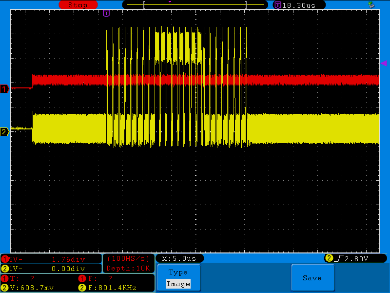

Sadly, even after that, I could not get the proper signal that I expected so I decided to create a set of samples that would allow me to clearly see what's happening on the output:
sample indexes left right
0 - 1 10000000'00000000'00000110'00000000 10000000'00000000'00001010'00000000
2 - 3 10000000'00000000'00010010'00000000 10000000'00000000'00100010'00000000
4 - 5 10000000'00000000'01000010'00000000 10000000'00000000'10000010'00000000
6 - 7 11111111'11111111'11111010'00000000 11111111'11111111'11110110'00000000
8 - 9 11111111'11111111'11101110'00000000 11111111'11111111'11011110'00000000
10 - 11 11111111'11111111'10111110'00000000 11111111'11111111'01111110'00000000
12 - 13 11111111'11111110'11111110'00000000 11111111'11111101'11111110'00000000
14 - 15 11111111'11111011'11111110'00000000 11111111'11110111'11111110'00000000
16 - 17 11111111'11101111'11111110'00000000 11111111'11011111'11111110'00000000
18 - 19 11111111'10111111'11111110'00000000 11111111'01111111'11111110'00000000
20 - 21 11111110'11111111'11111110'00000000 11111101'11111111'11111110'00000000
22 - 23 11111011'11111111'11111110'00000000 11110111'11111111'11111110'00000000
24 - 25 11000000'00000000'00000010'00000000 10000000'00000000'00000010'00000000
The basic idea is to have a marker bit be at a different place in all samples to easily identify them, while having the lowest 8 bits at zero as they will get ignored.
The code that sends all those basically does this:
Activate Audio subsystem
Turn off both TX channels
Fill transmission FIFOs (this consumes 2*4 samples)
Turn on both TX channels
While there are samples remaining, wait for space in FIFOs, place one sample for left, one for right in their respective FIFO
Now that all samples are in the FIFOs, wait for them to get empty
Using the "capture to file" feature of my DSO (thanks again E14, it's really a nice one), and a bit of editing in Paint.Net, I'm getting the following trace on the output pin:
So, the 8 queued samples are sent just fine, then an additional 4 as well, but after that, the subsystem keeps repeating samples 4 and 5 until I turn off the TX channels, for no reasons that are obvious to me.
I understand that the subsystem will repeat the last sample it has received if I'm not providing new samples fast enough, but I'm sure they are all placed in the FIFO as the while loops exit. And why repeat #4 and #5 when clearly 6 others have been given (and sent) afterwards?
In the Audio subsystem example provided in the MSDK, they are using the interrupt vector which I'll try using over the week-end to see if it helps.
In the meantime, does this situation sound familiar to any of you? Would you have any recommendation?

    jc2048 11 months ago
    Is it possibly down to all the printf debug statements wasting too much time so it can't keep up?
  • obones
    obones 11 months ago in reply to jc2048
    I thought that too, but they weren't there in the loop when I did the capture above. I only added them to try to figure out what's going on, and it did not change the result.
    Here is the output with the printf:

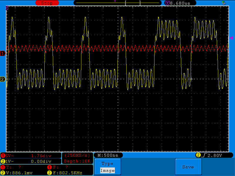

    The end goal is to generate a bit sequence suitable for WS281B LEDs inside the FastLED library. But it could also be outside FastLED, I'm just trying to generate the proper sequence.
    Thing is, bit banging cannot work, the fastest I can turn on / turn off a single pin is 600ns for a complete cycle. And that's without any code between the two pin set instructions.
    I thought about using the pulse train engine, but that's not desirable as it gets output on pins that are not routed on that board
    Hence the reason I'm trying to use the Audio subsystem with a clock set at 8MHz, and it seems that I can get the proper signal, provided I make sure the read/write of samples happens quite fast:
    The 1250ns per byte are there, with the expected Ton for 0 or 1 so that should work.
    Well, I say should because it seems the 900mV that appear on the line before the bits are output is interfering with the level shifter that I'm using, the same one that works fine with an ESP32.
    I updated the code at Github, on to chase a way to get rid of that 900mV and see if it helps

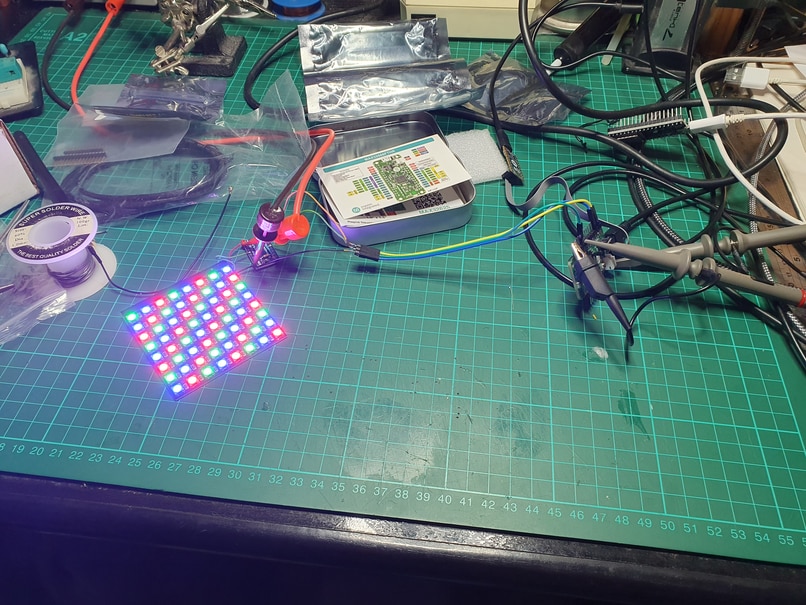

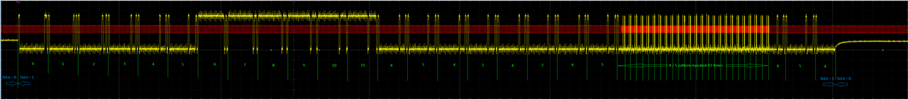

    Well, after lots of fiddling with code, I managed to get what I want:
    These are timings for 26 samples sent via I2S
    And pushing even further, I was finally able to address all 64 LEDs with a nice repeating pattern:
    With the first hurdle out of the way, let's move on to the next ones: BMI160, SDHC, BTLE...
