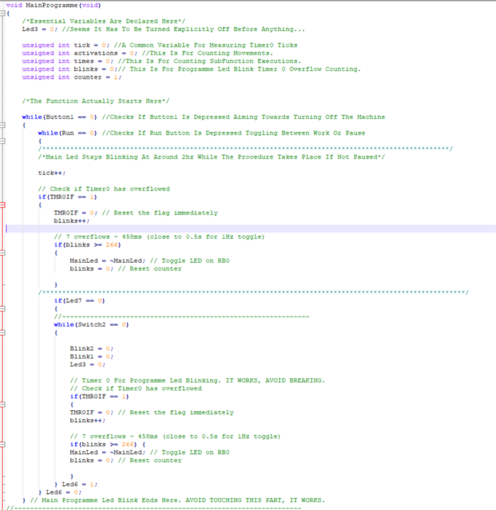

I am trying to create a firmware for Pic16f877A, using mplab 6.15 on gnu/linux and  pickit 3.
After finding out code examples in C language i could try and test parts to build a working piece of source code for it. However, i am finding myself at odds whenever i do wish to get actual work done.
I do wish to drive some leds on an off in sequences, sometimes turning on one, off other several times and holding them off some minutes to do it back. I could accomplish part of it using something called "fizz buzz" example and reading ticks from Timer 1's prescaler. My C and PIC knowledge is not yet the best.
The major problem i am struggling with is that, i can get 2 leds toggling one after the other, but if i try to get that within a FOR cycle, it either never stops if i do not add any code at FOR's end, or if i add code, it inmediatly jumps to it avoiding to toggle the leds altogether. If i code them off after for() they stay off, if i code them on after for, they stay offf.
The source code i am in trouble with is this one:

    I don't quite fully understand what you did so far and what the goal would be, but I can see several problems:
    The for loop you made is an infinite loop, because 'times' is unsigned, aka. it can never be lower than 0, and the condition for the for loop to finish is 'times' being lower than 0.
    Also, the 'if (counter % 3 == 0)' part increments 'times', and the for loop decrements it, so they are actively fighting one another. You might've intended for that to happen, but this is not generally a good idea to do: the rule of thumb is to use a for loop if you already know how many times you want the loop to run, or use a while loop if you don't.
    Another problematic part is the speed of execution. You're checking the counter's value in the for loop in multiple places, but that loop will execute many thousands of times faster than the counter's increment speed.
    If I were you, I'd probably start from scratch, and ignore the hardware timer for now. Have a big while(1) loop with a __delay_ms(10); at the end, and just increment your own counter somewhere. Getting an Arduino, and going through the Arduino IDE's examples(like 'Blink without delay()') to learn the logic and program flow for such a microcontroller would probably be the ideal path, as the learning curve is much gentler there.

  • michaelkellett
    0 michaelkellett 2 months ago in reply to madthescientist
    An unsigned variable can reach zero, but it can't be negative.
    Change
    for(times = 10; times >= 0; times --)
    to
    for(times = 10; times > 0; times --)
    or better to
    for(times = 0u; times < 10u; times++)
    (The u tells the C compiler that the 10 (and the 0) are unsigned - arguably pedantic and it will work without in this case)
    (and when you have  a free choice make your 'for' loops increment because it's much more common and will help you avoid the occasional silly error, and you never get caught by the >=0 trap)
    I find your code almost impossible to follow because there is no indentation - is this because you didn't use any or because E14 lost it ?
    It would be good if you could repost it with indentation if you can:
    (I did this in Notepad++ set for C language)
    The indentation style is based on https://barrgroup.com/sites/default/files/barr_c_coding_standard_2018.pdf
    I'll take another look then and see if I can work out what is happening.
