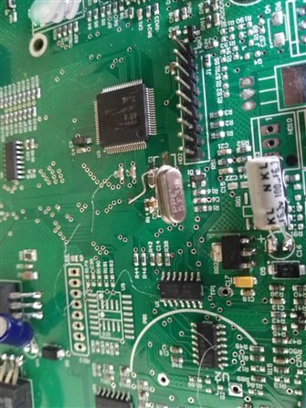

bonjour ,je suis embeté ,je dois repararer un tapis de course (console ) l afficheur ne s allume plus !je pense qu il s agit du quartz, et  je ne sais pas comment le tester (meme pour savoir sa valeur)  je cherche donc un quartz ,mais la referecne qui est ppf 5f318  ou ppf 5E318 est introuvable sur les sites ,qui pourrai m aider svp ,je suis novice.merci

    Christophe,
    Can you upload a larger photo, hopefully a good close-up in focus photo?  That will help us identify it, and suggest an equivalent replacement part.

    Hi Christopher,
    There's not enough information.
    Please could you supply a high resolution, detailed, in-focus photo of the area where the part was removed from? An area of around 50 x 50 mm.

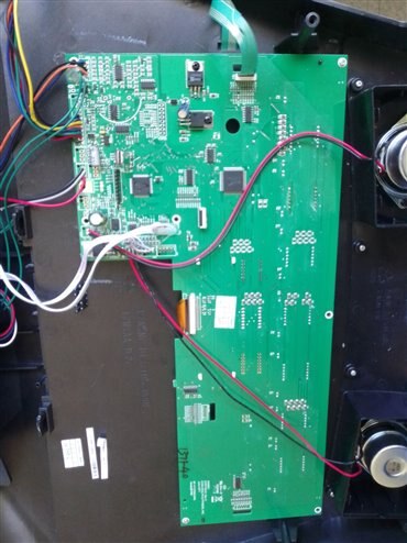

  • christophederouen
    christophederouen over 6 years ago in reply to shabaz
    Hello and thank you Would you like a photo of the electronic plate? j ai mi otherwise already a photo of the quartz,you can enlarge it by clicking on the photo a priori.

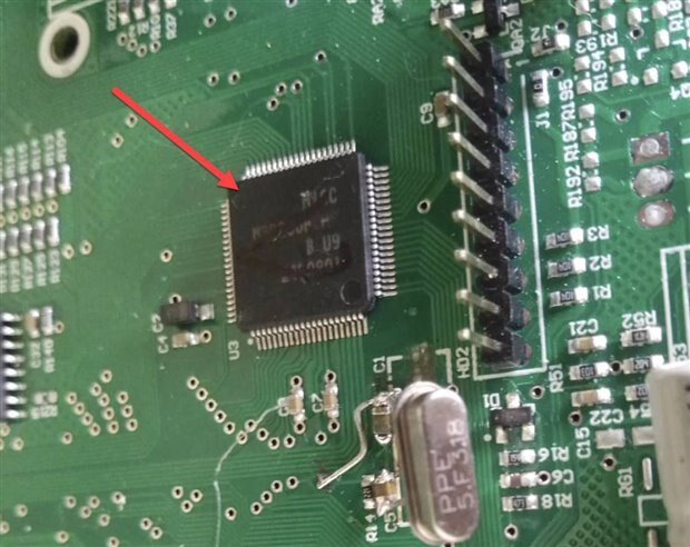

    bonjour voici ce qui est ecrit  sur la piece designé avec la fleche rouge :
         M i 6 c
         M 30280 schi
         BU 9
        249080
      Merci
    shabaz over 6 years ago in reply to christophederouen
    Hi Christophe,
    I don't recognise this. Maybe others who respond might.
    You could try guessing and try any 8 MHz or a 12 or 16 MHz crystal, and see if it works or not. A significant problem is you've now got at least two things to try to solve, and they might or might not be related.. finding the correct crystal, and finding the backlight problem.
    If someone has swapped out the capacitors and if it has not worked since, then the capacitors need changing too. Since I can't recognise the chip, I don't know what value to suggest.. maybe 12 pF as a starting point. Or you may need to contact the manufacturer and hope they can help (they may or may not help).
    thank you for your answer,in fact we had changed the capacitors and some components to test them with an oscilloscope ( they were good a priori ),we had therefore replaced with others to be on ,and c is at this moment where the quartz c is deprogramming or hs (we must build a quartz test to check it before ,to be sure if it is good or not!
    . If someone has swapped out the capacitors and if it has not worked since, then the capacitors need changing too.(Si quelqu’un a remplacé les condensateurs et si cela n’a pas fonctionné depuis, alors les condensateurs doivent changer aussi)
    not understood your answer? ! yes we had changed the capacitors ,c is at this moment where the display was lost a priori ,and we remids the old ones but without succes,at the beginning we look for the problem that the treadmill worked only after noon because in the morning,the house where it is found is wet!
