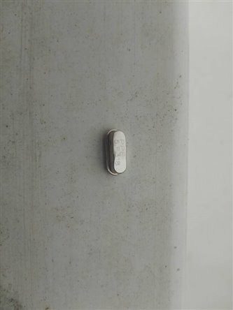

bonjour ,je suis embeté ,je dois repararer un tapis de course (console ) l afficheur ne s allume plus !je pense qu il s agit du quartz, et  je ne sais pas comment le tester (meme pour savoir sa valeur)  je cherche donc un quartz ,mais la referecne qui est ppf 5f318  ou ppf 5E318 est introuvable sur les sites ,qui pourrai m aider svp ,je suis novice.merci

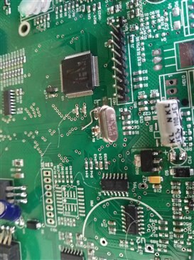

    shabaz over 5 years ago in reply to christophederouen
    Hi Christophe,
    You can insert more than one photo in a single response, no need for so many separate responses (it generated 10 e-mails for me - almost thought it was spam).
    Anyway, all the text/numbers on this part are needed.
    The board looks a wreck.. repaired by someone who didn't know what they were doing. Are you sure that quartz crystal is the correct one? Your photo shows a through-hole part, but the PCB pads look rectangular, like that needed for a surface-mount part.
    Did it ever function with the through-hole part? Do you have a photo of the original surface-mount part?
    You may have to experiment and try different value crystals. But the text/numbers on the part shown in the photo below with the red arrow, may help but only slightly.

    thank you and sorry for all these messages! in fact we didn’t change anything ,the party that vs designed with the fleche was not changed! is the quartz (ppe 5f318 )put back on the plate and the one that was original! After, I do not know my more than ca! my concern is to find a quartz ,but no precise information on its value! so very complicated!
  • christophederouen
    christophederouen over 5 years ago in reply to shabaz
    We just put the quartz back before taking the photo! Not at all touched the rest!
