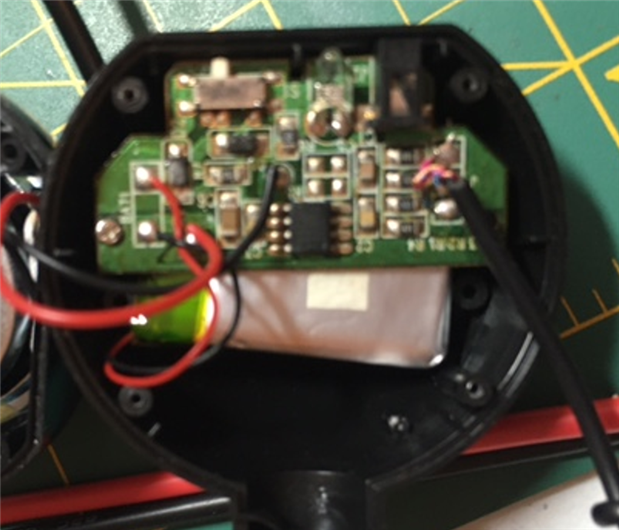

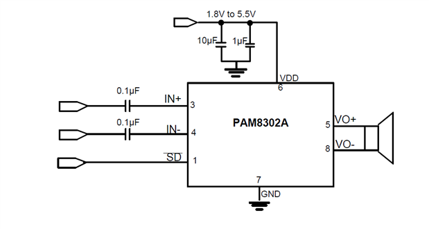

  • Sean_Miller
    Sean_Miller over 5 years ago
    Late to the party, but worth adding to the thread...
    I've become frustrated with the LM386 choices due to noise and size.  I have a speakerbomb that has amazingly - ha loud and clear audio, so I took it apart.
    Found it had a tiny, but awesomely simply to use PAM8302A chip.  It is shown below - the majority of components are the LiPo battery charging circuit.  The chip just needs your standard power and signal.
    It's also very cheap - half a buck.
