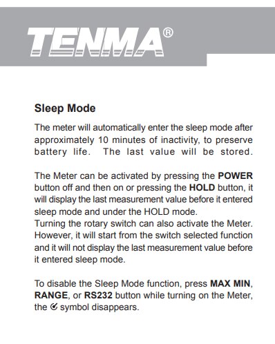

    jw0752 over 5 years ago +4
    Hi Max, Here is the How to from the Owners Manual: John

    I think I have just found the solution moments ago: I was looking at the display and it dawned on my the devices had not shut down for a good hour.
    The solution: I pressed te RS232 button, this lights up the RS232 indicator on the display. I can still operate the front-panel manually in RS232 mode but it does not seem to shut down so far. image
