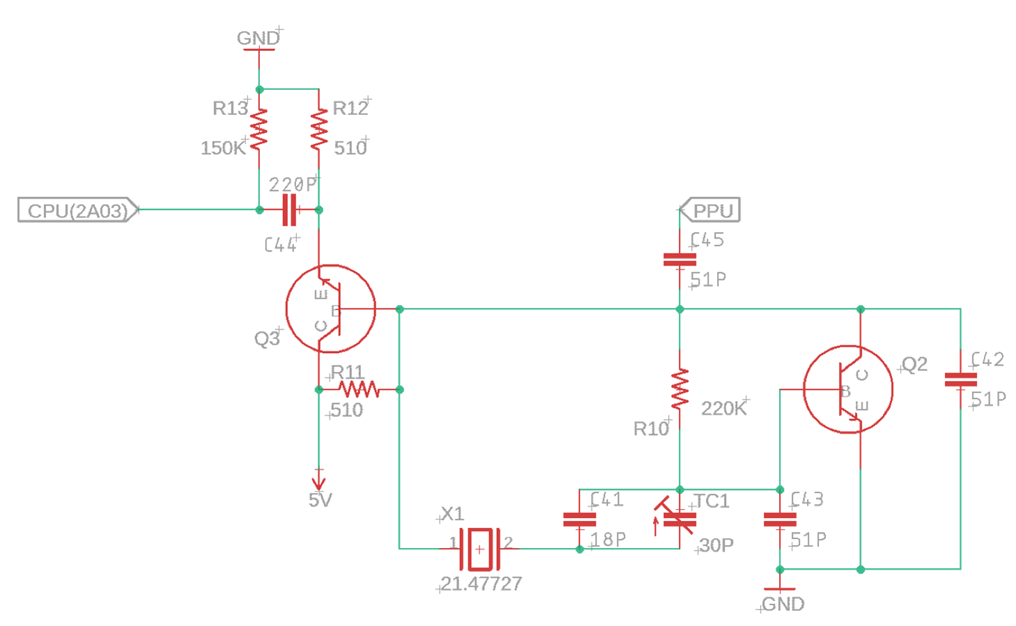

I'm not sure where to ask this but I'm a newbie and I'm looking for someone to look over a schematic before I try it so I don't break anything (specifically a 2A03 (6502 based NES CPU) I only have one). The idea is to hook enough of it up to get it running and interact with it with a Adruino Uno. The Adruino only has enough pins to look at the lower 8 bits of the address bus but I figure when I get to the Adruino script I can just respond to the $fc and $fd of the $fffc and $fffd reset vector and not send any JMP instructions to anything lower that $ff00 to get started poking around.
I'm specifically worried about the XTAL clock. Its based on StandaloneNesPlayer (soniktech.com) but I don't have a 74HCT04N so I figured I'd use a transistor for the not gate but my R2 value of 10k is arbitrary.
I attached the Eagle project (I'm new at that too)

    I don't think this oscillator will work. Use the recommended chip (or a ready made oscillator). BUT..... you seem to connecting the Arduino to the NES chip as if the Arduino were a memory device - what…
    Jan Cumps over 5 years ago in reply to splatkillwill +3
    The oscillator in the original article is a Pierce oscillator.

    As Michael says, you'll find this tricky to get right without some way of looking at the waveform coming out. This worked with an ordinary 16MHz AT-cut processor crystal and a 2N3904 transistor. I've biased…
    out.
    This worked with an ordinary 16MHz AT-cut processor crystal and a 2N3904 transistor. I've biased it to
    swing around 1.5V, which would suit a TTL level input. If it's a pure CMOS input, you'd want to move that
    up to 2.5V (by changing the base bias resistor).
    The collector resistor is a compromise. Increasing it increases the gain, but it doesn't then drive so
    well. In my case, 3.3k was better than 1k or 4k7 [I didn't experiment any further].
    For what you're doing with the 6502 clone, couldn't you just generate the clock from the Arduino and run
    everything at whatever speed it can manage to generate the signals at. Does it matter if you see it
    running at only a tenth of the normal speed, or whatever you get? The original 6502 parts were static and
    there was no minimum clock speed, so I don't imagine this device would be too fussy either. You could get
    the Arduino to control the reset too.

    Not only do you need a way of looking at the waveform, you also need to know how to use it properly. I had the 20MHz bandwidth limit on. This is what it looks like without
    so my circuit isn't producing a very nice waveform.

    I ended up putting the xtal back on the original board and getting the clock off of that but I'll have to look at this in more detail when I have time.
    Generating the clock from the Arduino was my first thought but I heard older chips might not persist the state of the registers if you run them too slow, also the 2A03 is a sound chip as well. My end goal is to use the sound chip part and I assumed the sound generation part would need the right clock to sound right.

    I ended up putting the xtal back on the original board and getting the clock off of there
    I see some activity on the data and address buses but if I hard code a NOP its still seems random (with a NOP the address bus should steadily increment by one).
