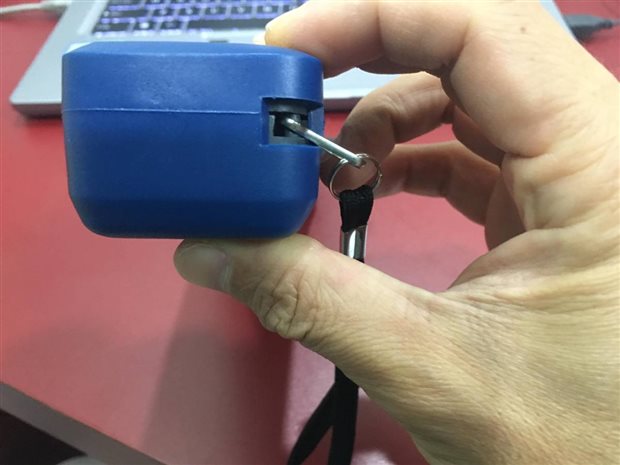

Does anyone know how to install battery into this tester?

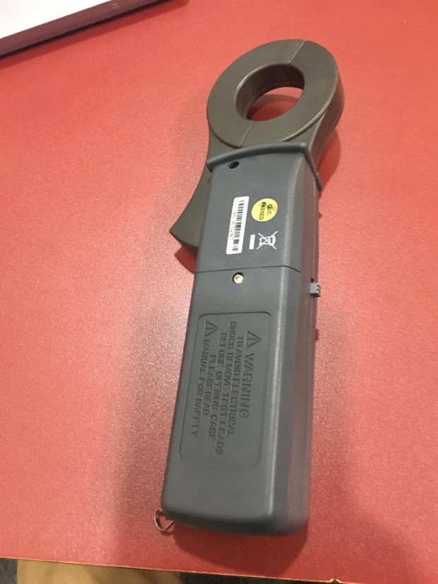

    Don't have one myself but it seems you may need to pry the rubber protective rubber cover off and slide the unit out to access any battery compartment (often behind a screwed flap).
    dougw over 5 years ago +1
    According to the manual there is a screw holding the 9V battery cover, which slides off. http://www.farnell.com/datasheets/2813670.pdf

    Obviously, the manual was wrong. There is not a single screw visible from outside. The battery compartment cover also nowhere to be found. I was wonder is it manufacturing defect or design fault? If I really have to pry open the case to install the battery, then it is definitely a design failure.

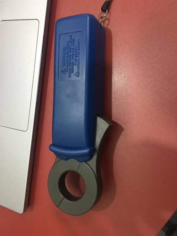

    Try removing the protective rubber cover as Gough suggested if you haven't already.  It is separate from the case and it is not uncommon for portable meters to have removable covers as protection.  See for example my Extech meter with the cover removed.
    dougw over 5 years ago in reply to fmilburn
    It would be interesting to see how the rubber cover comes off since the clamp comes through it on 2 sides and the display would come out a third side?
  • Gough Lui
    Gough Lui over 5 years ago in reply to dougw

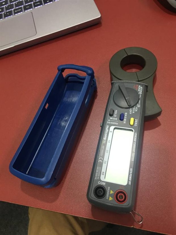

    I would expect the region around the jaw will expand far enough for the whole unit to be pulled through the hole in the rubber on that side. But for that to happen, you might have to first raise the rubber on each side as it might sit in a groove/channel to keep the rubber "snug" to the unit.

    Finally, it came off. Is not hard to remove the cover but a bit tedious to put back in as the is a button and a wrist strap need to be aligned to the cover cavity. Thanks for the suggestion, it really helps a lot. The manual should be revised so that newbies like me wouldn't get lost trying to insert a battery image
