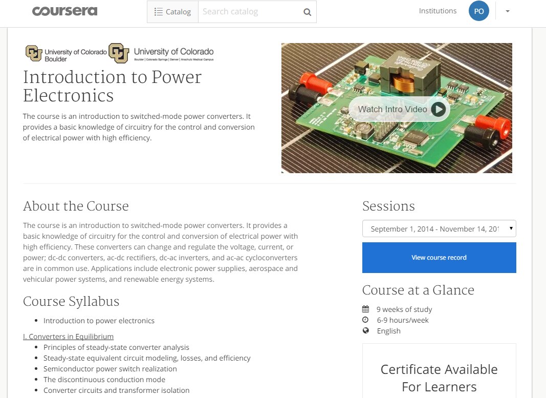

  • Robert Peter Oakes
    Robert Peter Oakes over 10 years ago in reply to uscdadnyc
    this is what I see and the dropdown under sessions only shows future sessions and adds me to a wait list. is it possible it does not like me being in Canada or the course is full ??
  • uscdadnyc
    uscdadnyc over 10 years ago in reply to Robert Peter Oakes
    IDK (I Don't Know) why you got the Screen-Shot that you did.Of course you DID create yourself a Login at the www.coursera.edu, Right? That screen of yours was what I got prior to when offered the again [25JAN16]  AAR there are work-arounds if you do Not want Certification. Get or give me (your) Gmail ID, sent to elyee000@gmail.com IDK whether Canada (or outside USA) IP addresses are singled out? I do not think so, but anything is possible.
