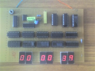

    Yes, yes you are absolutely right about 555 not being the right component. Actually 555 was used to generate 10Hz clock then I used decade counter to divide it by 10. Surely it wasn't accurate But as that was my first step in to this digital world and I made my first circuit, I was happy. That project really helped me to know how to solder, how to make connections between two Ic's etc (basic knowledge). That time I didn't knew about microcontrollers but later on I made many projects using microcontroller including a small digital clock using DS 1307. Check out my first project pic image

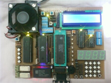

    Then after a year when I started with microcontroller I made my own development board
    and I believe I should save few more bucks to buy a good multimeter.
