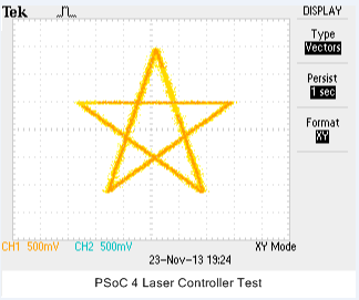

    If you already have two multimeters (and power supply) then the next piece of equipment to obtain should be an Oscilloscope.
    This is because it gives you a great visualisation of what your DUT (device under test) is doing.
    It provides a continuous log of readings over time like so!
