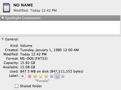

    Check the sdhc is FAT32 and not anything else.
    Clem
  • Former Member
    Former Member over 9 years ago in reply to clem57
    I think it FAT 32
