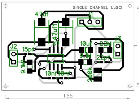

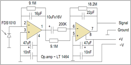

    I'm a postgraduate student at the Indian Institute of Astrophysics, Bangalore, India. I'm working on a 6- chaannel photodiode amplifier, which will be used for site surveys for a new telescope coming up in India.
    A dual JFET opamp (LT1464) powered by ±15V supply is used to amplify the signals from a very sensitive photodiode (Thorlabs FDS1010) In the first stage, the current in the range of nanoamperes from the photodiode is converted to desirable volt range by a resistance of 9.1MΩ.
    Thereafter, DC and AC components of the signal are separated and given different amplification coefficients with the second stage, along with another low pass filter that eliminates all frequencies above 400 Hz. AC component of the signal is amplified by 110 times, while the DC is amplified by 2 times so as to bring out the scintillations from what would have been a DC dominated signal. A high pass filter is also integrated into the circuit to only admit all frequencies over 0.1 Hz. Necessity of clean power requires appropriate smoothening capacitors, to be connected across the power supply of the amplifier
    With the current circuit configuration, the circuit tends to oscillate giving an output sinusoidal signal of less than 15V amplitude, without the application of any signal. According to Fig, it’s giving a sinusoidal signal of about 10-12V with NO DC offset, and a frequency of 564Hz in the absence of light from the LED (or for that matter, any light at all). Even when the photodiode was disconnected, the oscillations were still present, as shown in the figure
    Following is the PCB layout
    After reading more about PCB design, I found that the PCB was full of parasitic capacitances and there was plenty of crosstalk between the output of the six channels. So I decided to separate all the channels and adopt a better PCB design

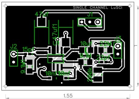

    I'm making another board after reading through some PCB guidelines. I'm populating it only with SMD Resistors and caps (hopefully reducing the noise) and giving a proper ground and power plane. So, can you tell me whether there's any problem with this design before I give it for fabrication?
    Following is the PCB design without the ground plane (for better visibility of the layout)

    Lupo over 14 years ago in reply to e14 Contributor
    Hi,
    I think you should better displace components, reducing trace lengths and loop areas. For example move 22pF and 15pF more closely to the opamp and change the routing of the connection between 10uF and 200K, avoiding the big loop around J3. Try also with traces mainly in one direction on one pcb side and perpendicular on the other one. In order to reduce parasitic capacitance, you should design pcb avoiding traces running too close on the same side or too close between the two pcb sides.  In such critical circuit, pcb must be designed with care in order to avoid big issues.
    Hope this help.

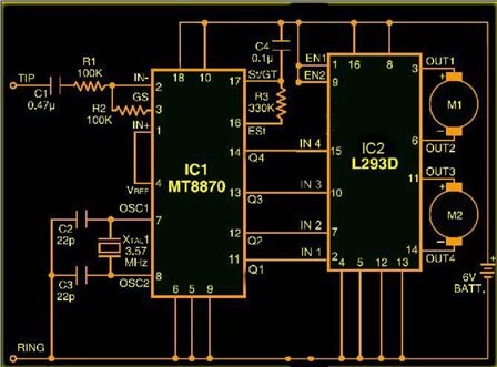

    mam,i tried to make a mobile controlled car,,without using microcontroller and using mt8870 and l293d ic ..but wheni placed leds at 11 ,12,13,14 ports of mt8870 leds were glowing but when i connect mt8870 with l293d motors are not working ..please help me to resolve this problem...image
