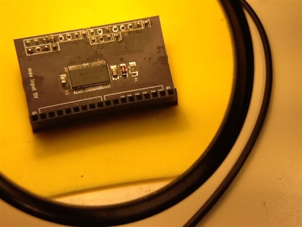

    Jan Cumps over 11 years ago +1 suggested
    Hey, this is the first time that I can recommend the same IC in two different questions: SN74CBT16245DGGR: 16-Bit FET Bus that can switch two groups of 8 pins. Very fast. (I also recommended it for another…

    0 Jan Cumps over 11 years ago
    (I also recommended it for another purpose in this discussion: TTL to CMOS protection / recommendation).

    0 Jan Cumps over 11 years ago in reply to Robert Peter Oakes
    ... and it is solderable. One of the first SMD exercises I did was this IC (the first was an OPA2170 - SOIC-8. The SN74CBT16245DGGR is TSSOP-48).
    With paste and hot air it works rather well. SMD isn't that hard for these types of packages).
    Result:

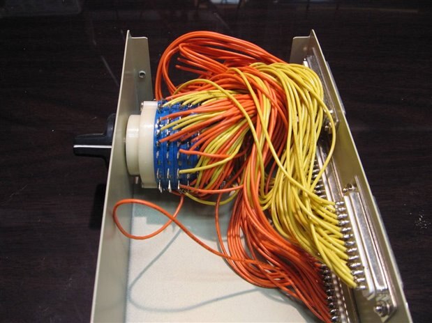

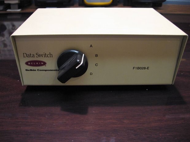

    0 jw0752 over 11 years ago
    Hi Per,
    Here is a switch that can switch 25 lines to position A or B. I used to use switches like this for multiple printers on one computer. You will not need 25 lines but it would be relatively easy to tap into 8 of them.
    http://www.ebay.com/itm/2way-DB25-pin-wire-AB-Manual-Data-Switch-Box-Parallel-Printer-LPT-Device-SHdis-T-/121694397454?hash=item1c558d240e
  • Robert Peter Oakes
    0 Robert Peter Oakes over 11 years ago in reply to jw0752
    It may not be switching all 25 lines so beware, Centronics printers have alot of grounds so many may be common to both sides and only the 8 data and a few handshake will be switched, but even this is enough to meet the askers requirements
    0 jw0752 over 11 years ago in reply to Robert Peter Oakes
    Hi Peter,
    I have a couple of DB 25 4 throw switches and I cracked one open to see if there was a problem with grounds not being switched. At least in the case of this one all 25 lines are switched. Obviously a 2 throw switch would not be as much of a rats nest as my 4 throw.
