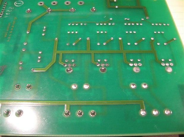

    Many of the circuit boards used in dental equipment have a coating of clear epoxy paint. These boards are used in sterilizers and other equipment that are in close contact to water and steam. They seem to work well for extended periods of time. Here is an example where you can see the layer of coating. In some instances the coating is even thicker. I don't know if this would be applicable to your situation but the coating directly on the board eliminates the possibility of pockets of trapped liquid or moisture.
