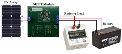

  • michaelkellett
    0 michaelkellett over 6 years ago in reply to piyushy
    Study the schematic, it tells you the max current for Vsys.
    Vsys is not regulated, it will be battery voltage or more.

    0 piyushy over 6 years ago in reply to michaelkellett
    Ok.
    My load requires 40A, so should I then connect it directly to my battery like in the image below?
  • piyushy
    Ok.
