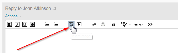

    0 luislabmo over 7 years ago in reply to jatkinsonn
    Hi John,
    Try adding a picture to one of your comments -you can reply to an existing one or add a new comment-. This way other members may be able to help you.image
    -or copy & paste works too
    Luis
