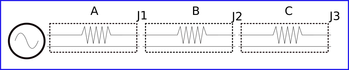

    ML, I have attached a rough drawing to assist in my explanation of what you are trying to analyse. In my example there is a signal source on the left feeding a connection of three pieces of wire (A,B &C).
    Each piece of wire has physical characteristics that impact it electrical properties (i.e. it ability to pass signal). Of the three electrical properties resistance, capacitance and inductance, I will speak to resistance. For this discussion lets keep all the wires the same type of metal. Again different metal different electrical properties. The smaller the gauge of wire (i.e. AWG 8 vs AWG 10) the larger the conductors, the lower the resistance. The gauge size compared to resistance values being opposite can be confusing.
    The resistance of the conductor, limits the amount of current the conductor can carry. If you attempt to move more current through the conductor that fessible the metal will heat up (because of resistance) and may melt the insulation. The current flowing through the conductor resistance causes some of the signal (voltage) to be lost. We start with a signal at the source but depending on the electrical properties of the conductor the signal at J1 will be reduced and reduced again further at J2 & J3.
    Let's examine this scenario. The first conductor A is large, with B being smaller and C being smaller still. The limiting factor for the circuit is the size of the smallest conductor. The initial conductors may handle the current but if the smallest can't it become a fuse and will open from overheating.
    Let's look at the signal. You start with an supply value at the source, that you want to arrive at the destination. As the signal passes through each conductor it is getting reduced. The amount of reduction is dependent on the resistance. If the conductors are long, and the gauge makes the conductors small, there is a lot of resistance for the signal to pass through.
    A perfect example of resistance at work is the extension cord. Most people purchase an extension cord based on price. Wow, I got a 50ft extension cord for $15. What people fail to look at is the gauge of the cord. 50ft of AWG 18 has more resistance than 50ft AWG 14. Rarely do 50ft 12AWG extension cords go on sale.
    The consumer runs their weed wacker on an extension cord of 50ft but a small conductor. That is hard on the motor and the cord. The voltage at the end of the weed wacker is going to be reduced because of the current flowing through the resistance of the smaller 18AWG wire vs 14AWG wire.
    If each piece of wire was a pipe of varying size, the fluid that flows out the end is limited by the smallest pipe. That is why the feed pipes to the house are larger than the pipes that go to each of the taps. If not when you flush the toilet, the shower pressure drop since water has to come from some where if the feed is the same diameter as the taps.
