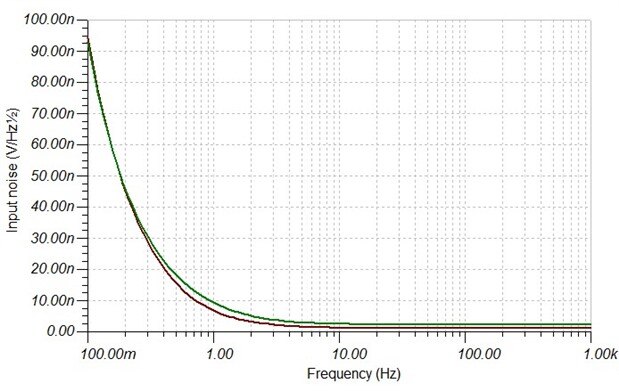

Does anyone have any experience of simulating noise performance with SPICE?
I'm playing around (in Tina-TI) with an old discrete audio preamp design that was originally intended for use with a pickup coil (moving-coil). If I ask for the input-referenced noise, it gives me this
That looks quite plausible, with the 1/f noise in place and a sensible level for the white noise (1 or 2 nV/rtHz - higher than a very good bipolar low-noise op-amp, but still quite respectable). One thing I'm unsure of is the low corner frequency. An OP27 would be around 2.5Hz, and that's very, very good, so a third of a Hertz looks too good to be true, although this design does use a medium-power transistor in a common-base arrangement at the input, which is obviously something the chip people can't do.
Would it be reasonable to expect transistors to have sensible noise figures in their models?

    If you have AOE (Art of Electronics) third edition there is a lot of good stuff about discrete device noise in there.
    If you plotted on a log scale I think the 1/f corner (3dB rise in noise) is nearer 3Hz than 0.33 Hz.
    1/f noise "definition" here:
    https://www.analog.com/en/analog-dialogue/articles/understanding-and-eliminating-1-f-noise.html
    Spice models are very variable, some good, some bad - no way of telling which you have, other than by comparison with reality.
    I've found discrete MOSFET and transistor models to be worse than IC models.
    My only real life use of small power transistors for low noise was very poor on 1/f corner - but OK for us at 10kHz.
    MK

    Thanks Michael, that's just what I was after. I did wonder if maybe, because the transistor models
    are a part of SPICE, manufacturers might feel obliged to populate the various parameters
    accurately, but it's like all the rest of simulation: only as good as your models, so beware!
    The Tina help warns that op amp models may be simplified or not have any noise modelling at all,
    but so far I'm finding that models I get from manufacturer's do look to have reasonable modelling.
    Here's a selection, along with the discrete design I started with. [This time with a log scale. Why
    did I think I could judge a corner frequency from a linear scale and a constantly changing curve?]
    The OP27 is a bit off from the datasheet, but maybe the simulation model is biased more towards
    worst-case rather than the 'headline' typical figures they like to show on the datasheet. The CMOS
    OPA192 would be expected to have worse low frequency noise than the bipolar parts, but they've
    obviously done a lot of work to get a good wideband figure and the OP27 is a good bit better than
    an OP177 [which is fair enough, given what they're being pitched for and the price difference].
    Even without knowing much about all this, I suspect the discrete design is a bit optimistic when
    you see it against an OP27.
    Although simulation might not always be that useful for actual design, it's very good for
    educational purposes. There are two curves for the discrete design because there's a switch to
    change the gain. That changes the resistance seen by the base of the transistor and that's the
    result. Ouch!
    I might try building the discrete circuit as it's so simple, and do some measurements on it. I
    don't have the test equipment to do that well, but I could make a stab at the low frequency noise.
