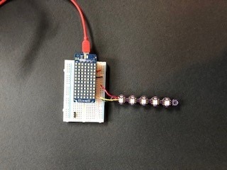

    Well, finally a sunny day.  Of course it isn't exactly mid-day in July in the Bahamas here in Portland but still.  I parked my car and put the LEDs on the back window facing into the sun and paced off 100 meters.  The LEDs look like this:
    There is an Arduino MKR1010 with a RGB shield on top and a small strip of 5 neopixels to the side with 15 mm spacing as that is all I had at hand.  The neopixels were driven at 100% from the 5V supply.  The RGB shield was driven at maybe 10% because the Arduino could not deliver the power at 100% without glitching.  I set them to flash alternately for about a second each with a seconds pause in between.
    I could still discern the strip at 70 meters but not well enough to make a claim at 100.  I think as much as anything that was due to the small size of the strip (6 cm first to last LED) and my relatively poor eyesight.  My thoughts are that increasing the density of the LEDs, having a longer strip / segment than 6 cm, maybe placing 2 strips side by side would make it visible.  A diffuser to spread the light might help as well provided it was not too opaque.  Putting a hood around it to give shade and improve contrast would help.  It isn't a direct comparison for your requirements but the RGB shield at 100% appeared to my eye to be much brighter than the rear brake lights on my car, at 20% they were dimmer.
    So this wasn't an entirely satisfactory experiment but I believe WS2812 can be made to work.  The links that Gerard provided would be good ideas to follow up on.  You might need to experiment a bit like I did.  In any event good luck, it sounds like an interesting project.
