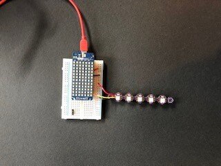

    Hello Matthew, Have you looked at using WS2812 strips also sometimes called Neopixels? I have seen several large 7 segment displays made from them - for example these made for a clock. There may be 12…

    Hello Matthew,
    Have you looked at using WS2812 strips also sometimes called Neopixels?   I have seen several large 7 segment displays made from them - for example these made for a clock.  There may be 12 V versions, if not then a switching buck converter could be used to get 5 V
    edit: here is another one https://learn.adafruit.com/ninja-timer-giant-7-segment-display/overview

    0 line over 5 years ago in reply to fmilburn
    Hi Frank
    Thank you for the suggestion and a beautiful solution for indoor use but are these bright enough to be visible outdoors?
    Example: https://www.ukled.co.uk/led-strip-4-8w-m.html
    Spec quotes lumens per meter at 240lm.
    To construct a 400mm character, each segment would be 200mm long which is just 48lm.
    Sadly I don't think it would be visible in bright daylight from more than a few meters.
    I had come across the Ninja timer in my research - I think it's great (for indoors).
    I have been looking for suitable SMD devices - the viewing angles are great - but I haven't found the right combination of quantity, cost, power and brightness yet.
    What do you think?
    Regards Matthew

    0 fmilburn over 5 years ago in reply to line
    I think the segments that are lit will be visible if there is sufficient contrast in color and / or brightness compared to the unlit ones.  I have some and will try and do an experiment and capture the results outdoors on my phone - but it is raining here at the moment and it may be a day or so before we get good weather.

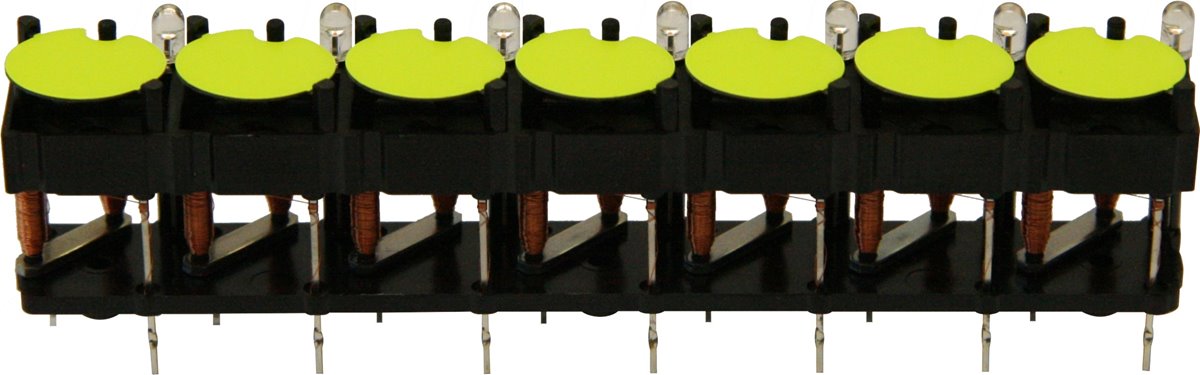

    0 beacon_dave over 5 years ago
    Another option may be flip-dot displays. Let the daylight do the work.
    https://www.buse.cz/en/components-and-technology/display-components-and-modules/display-flip-dot-and-flip-dot-led
    If it needs to be visible at night then there are the flip-dot-led hybrids which are available in strips of  7x 15mm dots:
    https://www.buse.cz/getattachment/Komponenty-a-technologie/Zobrazovaci-prvky-a-moduly/Zobrazovaci-prvky-flip-DOT-a-flip-…
    0 e14 Contributor over 5 years ago in reply to beacon_dave
    A great suggestion Dave - thanks.
    I had thought about using them.
    I think they are great for scoreboards and they make a great noise as they operate (clicking through) but I'd rather use digital (LEDs) than anything mechanical for this project. It's for outdoors and, long term, I think the mechanical components would be prone to sticking/jamming.
    Thanks for the suggestion.
