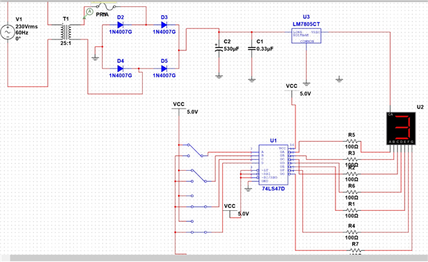

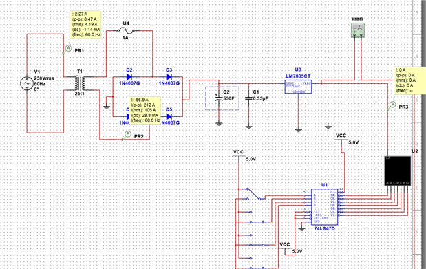

Every time I try to run the circuit the fuse breaks and the display turns off.
also I need the display to be supplied by the five voltage output from the power supply I designed
I attached the multisim file

    Hi Anwar, If C2 is really 530 Farads as depicted in your schematic it is going to look just like a short to the power supply. You will have to add a resistor between the power supply bridge output and…

    530F is a strange value for the capacitor - it's way, way too big (possibly a typo ?) If the current charging it was 10A it would take 53 seconds to get only 1V across the capacitor - can't be charged…

    How much value of the resistor that should be Between The Bridge and the C2, also I have added resistors between the seven segments and the decoder. And my problem is solved now. But I need to explain…

    If C2 is really 530 Farads as depicted in your schematic it is going to look just like a short to the power supply. You will have to add a resistor between the power supply bridge output and C2 to limit the current to a value that is less than the failure level of the fuse. At five volts and one amp the would be a value of about 5 ohms.
    also I have added resistors between the seven segments and the decoder. And my problem is solved now. But I need to explain in the project why I chose 100 ohm. is there a formula that I can use to calculate the RL
    0 jw0752 over 5 years ago in reply to anwar1
    If C2 is 530 uF then no resistor between the bridge and C2 is needed. Let's assume that your output voltage to the segments is 5 Volts, and that the voltage drop across the segments is 2 volts. 5 Volts - 2 volts is 3 Volts so that is the voltage that will drop across the resistor that we place in series with the segment. In this case you have chosen 100 ohms. If we apply Ohm's law to determine the current we get 3 Volts divided by 100 ohms which is 30 mA. I would consider this high for a a seven segment display. To make the display last longer 330 ohms might be better. You can also check the data sheet on the seven segment display to get more accurate junction drop voltages and recommended segment currents.
    If the current charging it was 10A it would take 53 seconds to get only 1V across the capacitor - can't be charged through a 1A fuse.
    You are using a simulator - so look at the current in the transformer secondary.
    A sensible value for the capacitor would be 470uF (about 1 million times smaller). (Biggish electrolytic capacitors are made in a limted range of values - 220, 330, 470, 560 uF are common, I've never seen a 530uF capacitor).
    Out of 22600 aluminium electrolytic caps Farnell offer 1410 at 470uF, 288 at 560uF, 40 at 510uF and none (0) at 530uF.
