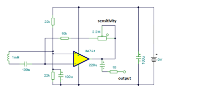

    0 e14 Contributor over 14 years ago in reply to e14 Contributor
    How about using the principles of a clamp meter? ie, make a small inductor coil to sense the current. You could crudely get away with something similar to this;
