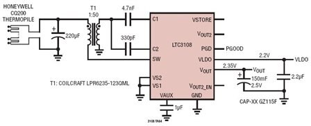

    Josh,
    Where do you plan on using this Peltier energy harvester?
    Here is a circuit that is powered by a Peltier and senses temperature. Low power sensor applications would be a good use of the effect. The more of a difference in between two surfaces the better your project will work.
    See more about this fully worked out project at Linear's site.
    Here is another.
    First of all, I recommend learning as much as you can about the Peltier. Build some projects that are already worked out, like the two above. Then, I would say, you know enough to venture out to build your unique project.
