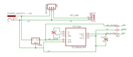

    That looks absolutely ideal for powering the RPI, but these small ready-built switchers sometimes have quite high ripple and noise, so maybe some strategy like this could be worth considering
    (excuse the poor diag). Some of this is just trial-and-error, it may not be the best approach.
    Here, +5V analog supply is via the low-cost 7805 linear supply circuit, it doesn't need a heatsink, it could possibly be a smaller 78L05 depending on power dissipation calculations (I didn't do the calc)
    or could be a LP2950-5 for example. The -5V analog supply is using the TCA7662A followed by an optional LC filter. The values are not critical, just ballpark (to provide filter freq below 12kHz). Note the capacitor +ve end goes to 0v (hard to see on the crude diag).
    0 e14 Contributor over 13 years ago in reply to shabaz
    Ahh great, I've reproduced your schematic in eagle, but I wasn't too sure about the inductors:
    • 500µH 2A: http://uk.farnell.com/bourns-jw-miller/5256-rc/choke-500uh-2a-20-990khz/dp/1103553
    • 400µH 0.1A: I couldn't find any at this spec 400µH inductors were all roughly 3.6A..
    Also, would the 0V analog need to be completely separate to the 0V in the rest of the circuit? I was thinking of just having 3 Screw terminals with +5V 0V and -5V that could then be routed to the audio PCB with the PGA2311.
    Sorry if it's a bit messy! And thanks for your help, I really appreciate it!
    Edit: I forgot to add some capacitors into the 7805 circuit, probably a 100µF capactitor on the 12V side and a 100nF capcacitor on the 5V side.
    0 shabaz over 13 years ago in reply to e14 Contributor
    Hello,
    Thinking about this more last night, I had some suggestions. Firstly, the inductors:
    For something close to 400uH 0.1A, you could use this one. This is 470uH so a bit higher than needed, but this is fine.
    For the 500uH 2A, I just noticed the switcher datasheet says it run at a much higher freq, so you can use a far lower
    value, 10uH would be ok. This one should be fine (it is 1.6A).
    Regarding the rest of the topology, there is another improvement but it involves an additional regulator, the 79L05
    which is small (TO92 sized). Basically, you could power the TC7662A from 12V instead of 5V, and then it will generate -12V.
    Then, you could use the 79L05 to regulate to -5V. It may be overkill, but just something to consider.
    Regarding routing of wires, you are probably ok with your suggestion. The usual approach is to have separate wires from the
    supply (7805/TC7662A in this case), so that the path for current to flow from the digital supply rail through the PGA and
    into the 0V rail is kept separate from the analog path. So in other words, with the diagram above, two wires or paths from close to
    the OUT pin of the 7805 to your PGA, and two wires or paths close from the 0v area near the 7805 and TC7662A to the PGA.
    As you say, the 100nF on 5V side of 7805 would be needed. Even 10uF or lower on input side to 7805 would be ok.
