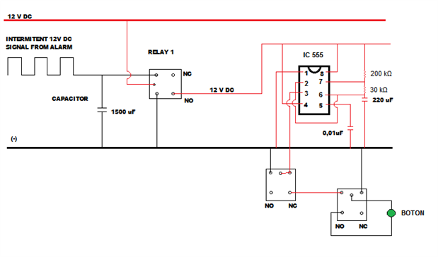

    Hey, Douglas. What do you think about this?
    According to some calculators I found online this will give me a 35 seconds ON and 5 seconds OFF output. Then I use a relay on the NC prong to invert it to 5 secs on and 35 secs off, which holds the button pressed for 5 secs and releases it for 35 secs. (BTW, "boton" means button in spanish image)
    Your circuit looks way better than mine, but it's too complicated for me. Besides, button press and release times may vary and it doesn't matter very much, since it's just a reminder. I can also fine tune it by changing the resistors of by using rheostats or potentiometers (i never understood the difference between those two) instead.
    Do you think this will work?
    Thanks!!!

    0 dougw over 11 years ago in reply to Former Member
    Hi Frederico,
    I is worth a try.
    The relays need to be low enough power such that the 555 can drive both at the same time.
    They should also have a snubber diode across their coils to protect the 555 from large voltage spikes when the coils turn off.
