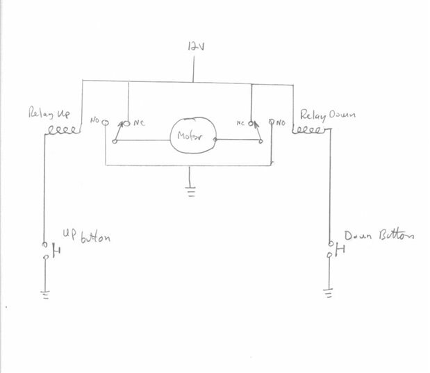

Dear All,
I am in searching for a solution which switches input power polarities.
Story: My car window regulator (together with the driving motor and the control module) is broken and I've ordered a new one which is a bit different than the original one. The new regulator has no control module, only a motor with 2 power cable (+/-); the car provides a wiring harness has one +12v output and two grounds, depending on the button you pulled or pushed, either of the grounds closed to complete the circuit. The original regulator control module will automatically switch the polarity to drive the motor up or down accordingly. However, the new one has no control module to do this.
Current Planning Solution: I am planning to utilize two relays and two MOSFETs to make such 'Polarity Switch' and here is the circuit diagram I've drawn. I haven't tested it yet (components are on their way from Element14 to me).
Question 1: Could anyone examine my circuit to find out whether it will work? If it does, will it still work if I replace the relay with straight wire?
Question 2: because of the relays, I am really not too confident about the reliability. Is there any other way to complete this 'polarity switching' purpose?
If it helps, the max voltage supplied is 15v (when the alternator is running), the fuse that is used for front window is 30A (maybe it's for both front window), so I assume that the max current draw is less than 30A.
Thanks for any input!

    This won't work, and will destroy your MOSFETs. If you really want to use a MOSFET method then there you could try an integrated circuit such as this one: http://www.st.com/web/catalog/sense_power/FM1965/SC1039/PF149527
    I'm not sure this is a good idea. I don't know about power window controllers but they may have protection circuitry that detect loads and auto reverse.

    0 shabaz over 11 years ago in reply to Former Member
    There is so much wrong with the diagram I don't know where to begin : ( Permanently energized coils, high risk of MOSFETs shorting rails and no gate drive consideration.
    There is no simple fix. The solution is a more complicated circuit, like the one mentioned. Also, that alone won't provide the safety features that the original controller may have had
    (such as reversing the motor if a load is encountered while closing).

    The relay is not permanently energized if you read my first post. There are two grounds which either will be closed depending on the user pull up or push down the button. Only one ground point is closed at the same time. Because you cannot push the button while pulling it up. This circuit is a 'normally open' circuit. Please consider the two ground points as switches.
    There is no 'reversing the motor' function originally within the controller, the only difference between the new one and the old one is the so-called 'one touch open/close' function which I don't even care about. The only thing that the original controller does is to reverse the polarity.
    The Power (+12v) Supply is high current circuit which is separated from the window button, so no need for low-current to high-current drive.

    How about this circuit. It would allow your switches to run relays which in turn would power the window up or down. This assumes that there are limit switches in the motor unit that will stop the window at top and bottom of travel. This way we eliminate the MOSFETs that were just confusing things.

    0 Former Member over 11 years ago in reply to jw0752
    It's Perfect! It's simple and effective!
    Although I haven't try it yet, I have strong feeling that this will work.
